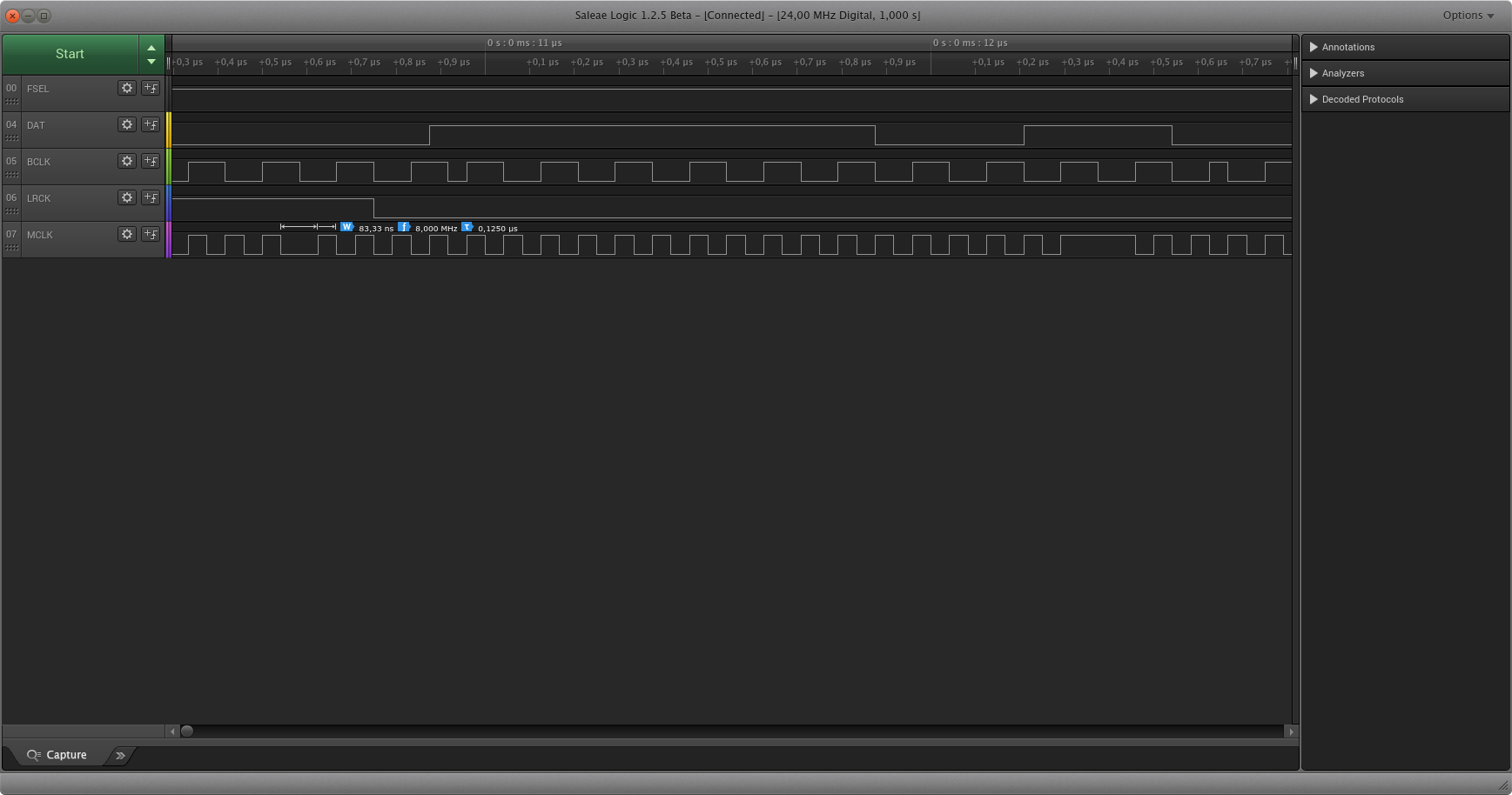

With the new firmware the MCLK pin now is clocking at 12288000 instead of 24576000.
Had to change the botic driver parameter snd_soc_botic.clk_48k to the new value in order for sound to play at normal speed from beaglebone black.
@Soekris, can you please verify if that is true. Further to that are there any plans for enabling FSEL in the next firmware?
MCLK/FSEL is not supported yet, although MCLK currently are supposed to output Master Clock divided by two, mostly for my testing. Did some changes to internal clock structure, will output div by two again in next version.
Implementing MCLK/FSEL is more a question about available time to set up testing, coding should be easy....
I tried my saleae logic analyzer and have noticed that MCLK has a few glitches. Is this normal?
That actually looks like glitch free clock switching when locking to new clock....
Well that capture is taken while the DAM had locked on signal and sound was playing. More to that in the measured setup MCLK was coming out of DAM to the beaglebone black which is slaved on the DAM. Could you please explain what you mean by locking to new clock? (Forgive my ignorance on this but I thought that MCLK should be steady clocking while locked on the signal)
Does the "24 Mhz" listed on the top line means it's sampling with 24 Mhz ? Then it's kinda useless....
