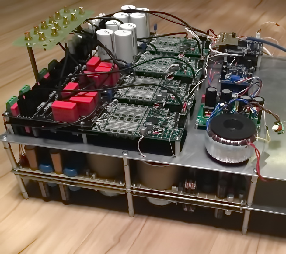

... you are left alone in the event of non-standard problems.. , such as in the project 8-channel DAC in the photo attached to the message.
You are not alone
I'm building an 8-channel DAC with four DAM boards and have no particular struggles with implementation...
Please tell us a little about your 8-ch project. It's truly monstrous!
What sort of problems do you have?
I2S interface used? Can't see from the photo...
