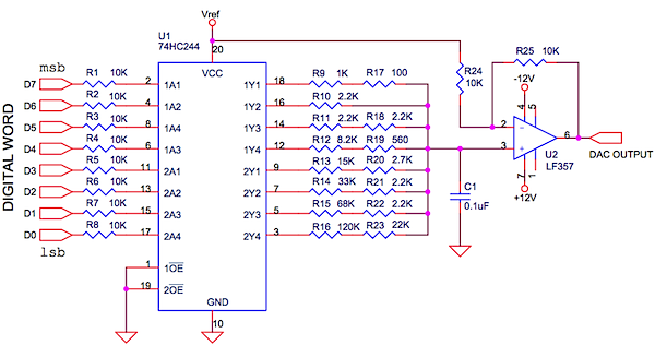

can anyone enlighten me to what this resistors are for

i sort of understand
what value resistors did you replace with?
how did find the correct values was just trail and error?
how much improvement was there?
can we bypass the lpf ?
Same as original ones 13R / 0.01. I do believe these two resistors are in MSB chain (like it is 100R in attached diagram of 8bit DAC)
Speed and uMicro details are vastly improved.
Taking out capacitor will basically disable LPF (no lpf).
Søren have done this, way back (se post #143 and #144 on page 15) when he was testing speed of DAM. It is good idea to ground lifted pin 3 of "LME49710 buffers " .

i had thought the 13rs were after the msb chain and would be a worthy experiment to short across them and remove the cap

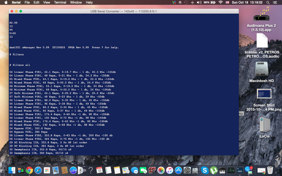

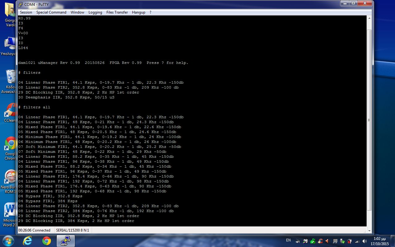

Hi all
As you can see in the first image with Windows7 and ExtraPutty, "filters" and "filters all" is working good.
In the second image MacBookPro and FastSpring.com program, typing
"filters all" it's ok, no result typing "filters"
Any idea??
"filters" command lists only the currently active filters. In the second image DAM1021 is not locked to a signal (no LXXX output), therefore no filters are active and it displays an empty list.

By locking he means audio signal locking (i.e. the DAC has locked to an audio stream and plays music)
The filters command shows the currently used filters by the DAC but if no sound is playing (i.e. the DAC lock led is blinking) then no filters are used.
