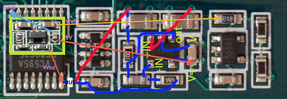

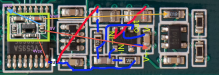

OPA365 should be the same as OAVQ ? and this is not point of my mod.
My mod is to replicate original Søren buffer x 16 (12 in reality) and place this new boards on the top of each LVC595A. Then lift pin 1 of LVC (cut board trace) and connect it to OPA365 buffer. Only two wires will connect each OPA buffer to original Søren buffer on the board; Vref and 5v.
Søren what is your opinion about this mod? and also do I need to lower Cx in Vreff line?
Cheers
Danny

Will there actually be any benefit given that surely the greatest step load is likely coming from the MSBs (ie : only four LV shift registers for the whole DAM)? I think additional capacitors will still be required?

Sorry, this is beyond where I will even comment on it, you're on your own....
I can only say to everybody else: Don't try it, the chances are pretty high that you ruin the board.

I feel the same the mod levels are going too deep I think soren its better that you add a LDO for each Shift register. That would solve the problem where everybody is worried about.

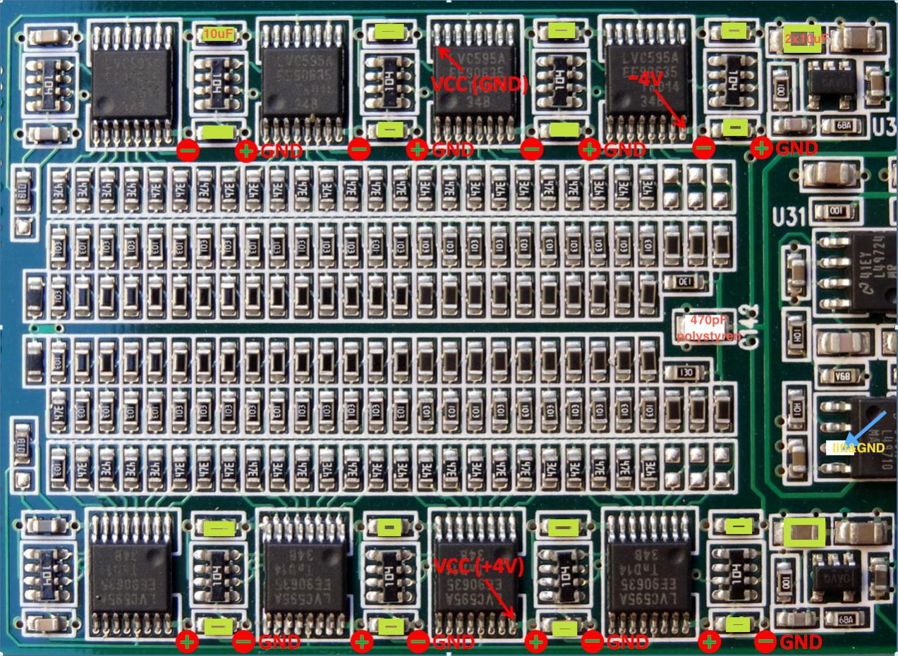

But I am not sure if the mod was worthwhile soundwise.
no big 3300+uF caps (turn DAM1021 into a boombox and no ceramics
I got the same feeling. The dam gets really "bass heavy". Almost a loudness effect.
I use 16*1000uf (16 cap mod) polymers in total. Total 16000/4 = 4000uf each vref.
Has anyone experimented with different cap values for the vref. Testing by ear and not with scope ?
I might try to reduce the capacitance and test?
I use 16*1000uf polymers in total. Total 4000uf
16 cap mod . 4 caps - each vref. Total 4000uf pr vref.

I did, replaced all ceramic shifter caps with 10uF stacked film plus 2x 10uF on OAVQ buffer = total per rail 60uF (no electrolytes any where). Also 1200pf with 470pF polystyrene caps and lifted leg of LM49710 (connected to the ground).No mod to OAVQ buffer (stock form). After low esr high caps mod plus resistors, comparing to stock DAM(my second board) I felt like "the trill is gone", all those uMcro guitar riffs, spouky notes of real sound, all turn into mushy background and boombox. So I took off all fancy mega uF ally NICHICON's And o boy what a difference, even PANDORA app now sings....not to mention HiRez flac, can't wait for DSD support......(this could be so far the best mod).....
now next is uncharted territory of OPA365 individual Vref buffer's mod, for which I believe does have merit because serving individually each shifter with its own buffer (lets say the "loudest" one in given time) would keep balance to the rest of R-2R . Thanks Søren any way on your comment.
cheers
Danny
