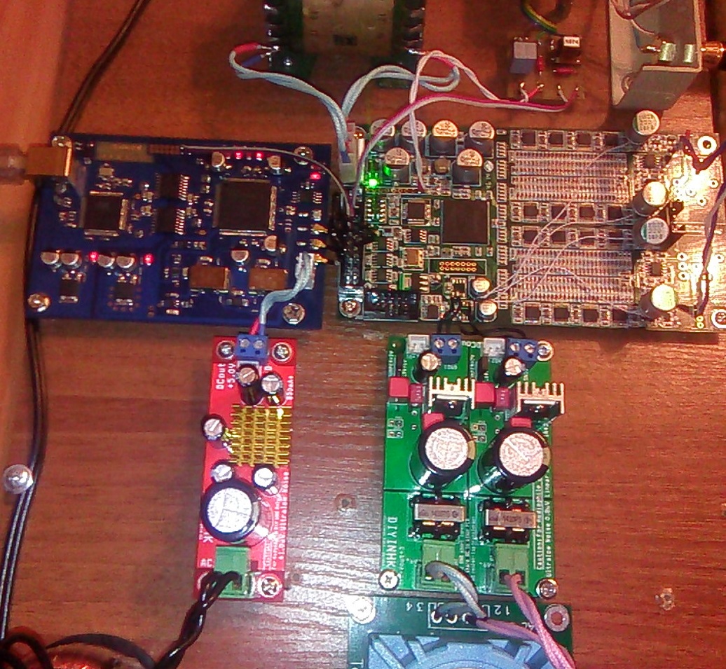

here my first results in Soekris mods.
the details will be later, but the most significant mod has not been described before and it is related to problem-solving in the opamps strapping.
