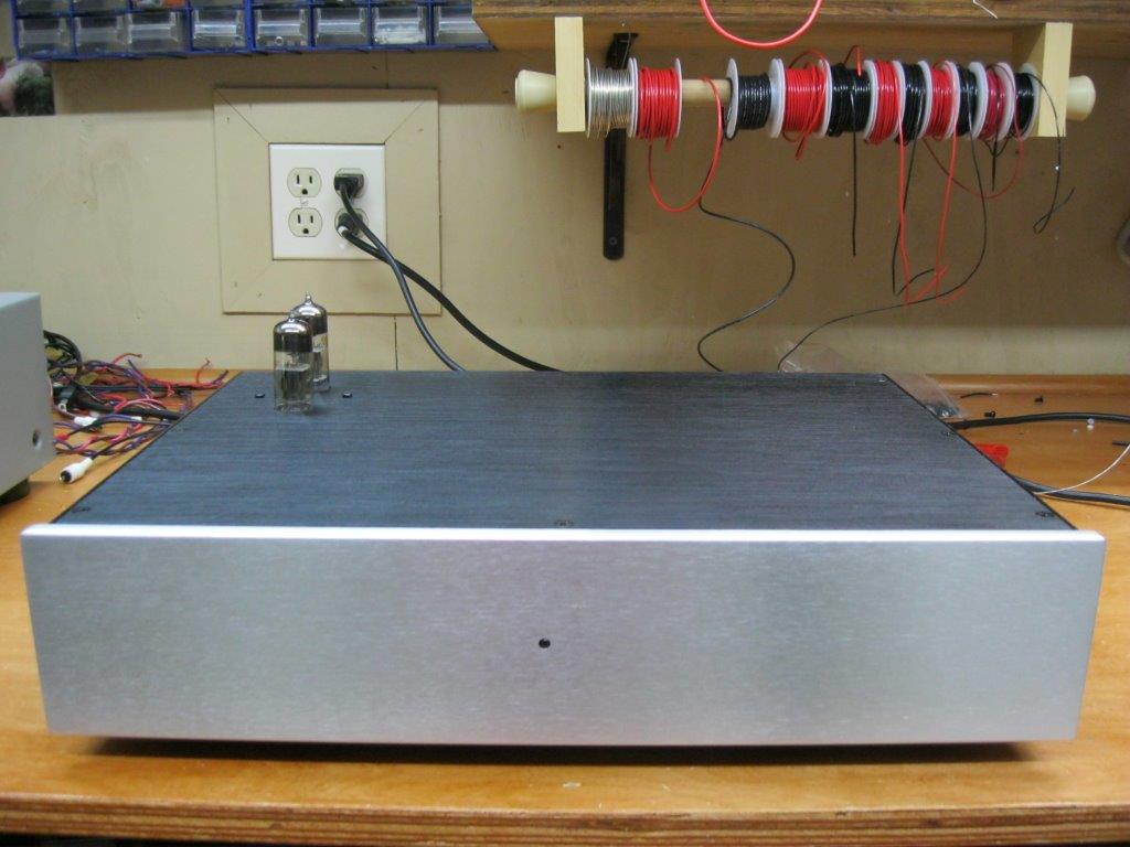

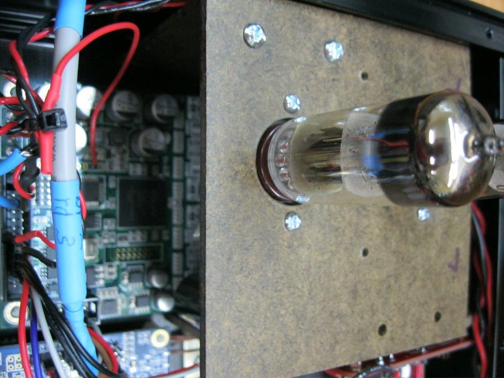

I attached some pics I took while I was still building the DAC. My goal was to keep connections as short as possible in a setup that uses 2 DACs (one for the main speakers, one for the sub) and a DSP. I am very satisfied with the results.
Chassis
Nice Chassis! Can you post a link to it? I might buy one.
...........I attached some pics I took while I was still building the DAC. .............
