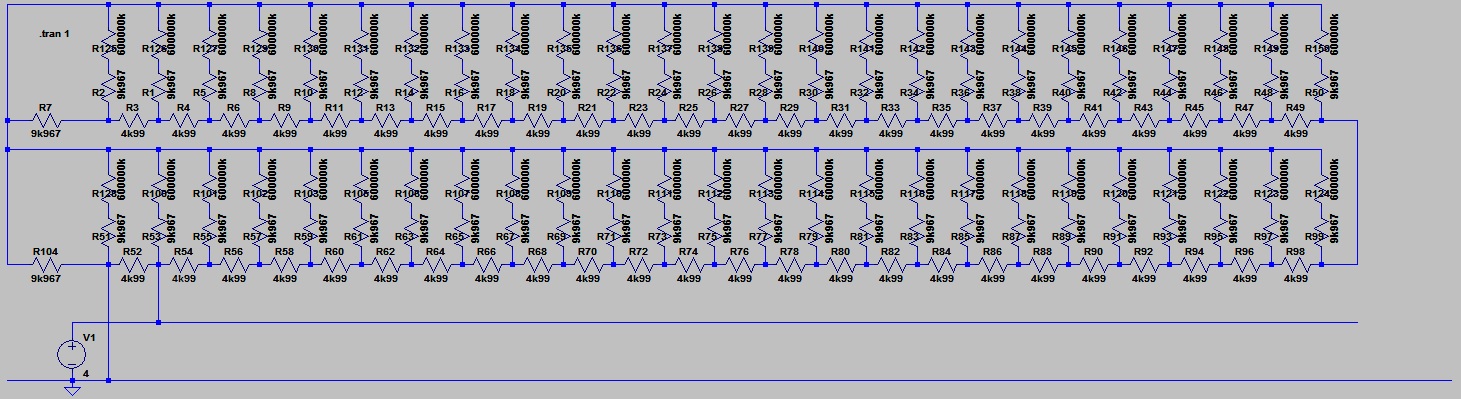

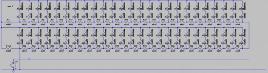

R is 4990 Oh.How did you measure? "in circuit" and DAC not powered I suppose.

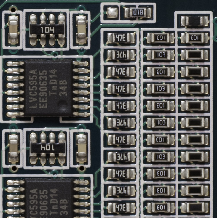

If you have a close look on the PCB, some of your assumptions on the topology seem not to be correct.
You see that "2R" is a 10k (103) with something big (47E) in parallel giving in total something slightly smaller 10k. The backbone of the ladder are the black ones with a resistance of around 5k.
2R is 9980. The switch have internal 13 Oh. Therefore the resistance has to be
9980-13 = 9967 Oh. = (10 K // 3.01 MoH)
If you draw two 24 R ladders in LTspice finished in a 2R. Measuring the impedance of any R 4990 Oh. will actually be 4890 because it has the rest of the circuit in parallel. So to measure the resistances 4990 "in circuit" and the DAC without power is not expected R 4990 to measure their value, theoretical in circuit 4890, but really 4893.5 because the mass to be added for some reason 3.5 Oh.
R is 4990 Oh.
Two things that could inflouence due the position of the measured R resistor:
When I measured the resistance with my high precision bench top multimeter the values were fluctuating nonsense. With a hand held multimeter I got plausible measurements (~10k, ~5k). I think that is due to the influence that the capacitor at the end of the ladder. This influence increases as closer you come to the end of the ladder and could explain your variation.
Less likely:
If you measure while the DAM is not powered the shift register connected to the 2R has a high resistance, I did not find the value in its data sheet, but if it is not very very high you get also an effect through the 2R part and that would be dependent on which R-resistor of the ladder you measure.

I had only 23 R in my ladder LTspice scheme. Now with 24 R all change. In parallel with R is 255K. In this case the value to measure would be 4994 Oh.Two things that could inflouence due the position of the measured R resistor:
Less likely:
And assuming an shift register impedance 600 MOh. The theoretical measured impedance would 4993.5 Oh.
Everything is in tolerances.
Except the first ten 2R. And the effect of lower resistance near the exit. May be near the condenser.

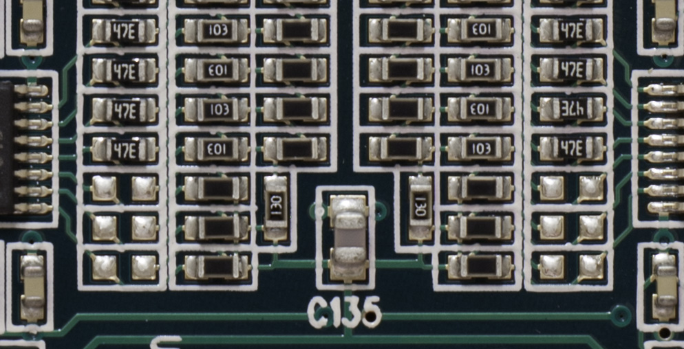

The output end of the ladder is to my opinion like that:
After the ordinary ladder (25 2R to shift register and 24 R backbone)
you have
a 13R (130) from backbone to output,
a R from shift register to output (for second last most significant bit),
two R in parallel from shift register to output (for the most significant bit),
It is a 28 bit sign magnitude DAC, so 1 bit sign (pos or neg ladder) and 27 bits magnitude in each ladder.

Maybe I should tell that it's actually what's called a segmented DAC, it consists of the 1 bit sign, a 2 bit unit element (also called thermometer) section for the two MSB bits, and a 25 bit R-2R section for the rest, totally 28 bits.
