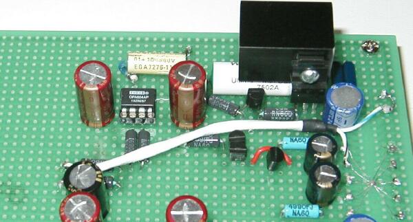

For Example
Sulzer type regulator. Veiw of positive half. Negative regulator half not finished.
Art
