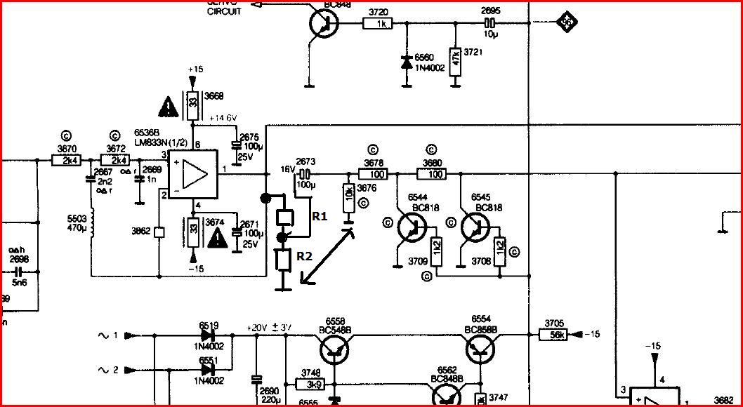

Let me get this clear: your CD has too much output for your line stage, so you reduce the gain of your line stage, then you need to boost the gain of your phono preamp and/or change your cartridge. It seems a lot of effort for a problem which can be solved with four resistors (two per channel)! (You already have resistors in your audio path - its called a volume control).
If you are happy to mod your equipment, why not simply bypass the line stage for CD input? That way you reduce noise and distortion too.

James1 is absolutely right to reduce his preamp's gain : if you read carefully his original post, for a given position of the preamp's potentiometer (even at the lower positions) the CD is too loud and the LP is too low. So, if you just decrease the CD's output voltage to adjust it equally to the phono source, the user must always put the volume control at high positions to have some reasonable sound level : by the way, the dividing resistive network is not a good solution for sound quality as described before in several posts by different members. Again, if you read James1's initial post carefully, this solution that every single young electronics amateur would suggest is indeed very cheap and simple to apply but it degrades signal integrity : yes, the preamp's attenuator acts like your preconized voltage divider but we all know that this is a very strategic part in the signal path simply because potentiometers alter sound quality !
If it's mandatory to use 1 at least, let's avoid using a second one...
As digital sources generally give 2-3 VRms (except some few high output level DACs like the DCS Elgar...) for a 0 dB recording, it's not sure at all that James1's DAC has a too high output voltage : you'll of course claim, as always with bold statements, that it's largely enough to saturate any amplifier's input but, in practice, this is not the case as most quality recordings never reach 0 dB, otherwise the DAC chip's output would saturate ! So, in order to keep some headroom margin for high-dynamics audio signal levels, the average output voltage is around the hundreds of millivolt range most of the time, and it reaches the volt range for some short periods. Of course, you can find junk recordings where the DAC output is often saturated but they are rarely listened to by audiophiles because of their poor sonic performance.
It seems that you are here to force James1 to chose absolutely your solution, which as always you consider as the only best one, but keep in mind that he has to cope with his own system's issue to find a satisfactory compromise !

why don't you use a 5k or 10k pot between the CD and preamp to find the proper level. (R1) Then measure the wiper to GND resistance and input(CD) to wiper. (R2) Try to keep the total series resistance (R1+R2) below 10k and above 5K to balance load and bandwidth concerns
Then buy 1% metal film resistors in the most correct ratio and solder them into an adapter connector.

Now James1 just has to check each suggested solution :
- the cheapest one would be to use the resistive dividing network : not before but after the interconnect cable (just at the preamp's CD input) to avoid coaxial cables' capacitive influence . In this case, the phono and CD levels being matched, the global level evolution still needs a far bigger raising of the volume control, as initially for the phono section.
- the most coherent one would be to increase Rg in the preamp's negative feedback network (Rg goes from (-) input to ground) to lower its gain, then to rise up the phono section gain and leave the CD's output stage as it was initially. In this case, there will be enough rotation margin for low and high listening levels for both CD and phono inputs. Lowering slightly the preamp's gain won't affect its stability, the voltage noise will decrease and the bandwidth will also rise slightly.
Both solutions are very easy to test and James1 can then tell us more about the one with the best sonic results, in practice. No need to be a PhD for it...

PoweRex - did you join up this month just to give us all wild and impractical solutions to easy problems?
There are many members on this forum with solid engineering chops. Blasting in here with difficult solutions to easy problems is not very polite. Especially when good, cheap, practical advice has been offered. Perhaps you should read the forum a bit and get a better feel for it. Enthusiasm is welcome. Running rough shod is not.
James. Try the simple resistive divider. It is likely all you will ever need.

Dear Panomaniac,
If you read my last post completely, you'll notice that I suggested to James1 to test both solutions and to make his own choice !
But it seems clearly that you force him to chose yours...
Both solutions are easy to test so let James1 chose, that's it.
