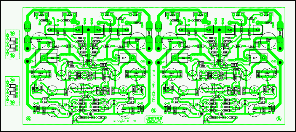

"I've done two Leach amps, both for other people that requested specifically that amp, and in a first one output devices were MJL3281/MJL1302, that also worked marvelously. I developed PCB for stereo version using that case (TO247), and I can post it too if there is any interest. "

Here is the version for TO247 case transistors. Only output coil is not on the board.

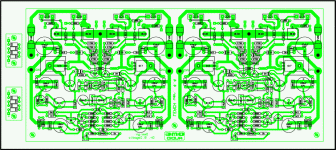

There should be a drawing for assembling previous version of the PCB as a GIF file with my last post, but I dont know why it has not been uploaded with that post?!

Is the part list same as this (expect output transistors):
http://users.ece.gatech.edu/~mleach/lowtim/part3.html
I think I will put some extra output devices so I have to change a little bit of your pcb.

Macgyver, it seems you skipped one of my posts. For Q1 up to Q11 I used 2N5551/2N5401. To me, they are better choice than MPSA and I am using them a lot.
There are some other changes because Prof. Leach and I do not agree on some issues.
I think that Leach's value of output coil is too small, and at the same time, value of R49 is too high. Value of around 4 to 5uH is much more appropriate and it should be shunted with no more than 2 to 3 ohms (2,2 ohms in my case). Those values are applicable to most amplifiers for they are generally not related to configuration but to the load impedance and amount of ringing with fast rising edges. In a waste majority of cases of such measurements, rising time of the leading edge of the square wave used, is not stated, but it is the most important factor for accuracy and relevance of such measurements. With the rising time of 1uS for example, you will find no or minimal ringing with good number of amps. Try them with 20nS rising square wave and you will see completely different picture. Higher values of output inductor will reduce ringing and reduction of the value of shunting resistor will improve things even further. Normally, there are limits and for an 8 Ohm load it will be typically a maximum of about 6uH, any larger than this will cause unacceptable attenuation of high frequencies. A 6uH inductor will introduce a low frequency loss (assuming 0.03 Ohm DC resistance of the coil) of 0.03dB and will be about 0.2dB down at 20kHz. These losses are insignificant, and will not be audible. In contrast, ringing (or in extreme cases, oscillation) of the output devices will be audible (even at very low levels) as increased distortion.
Of course, that's my point of view and I am not advocating that anyone should accept my suggestions.

You are right, and I am aware of that clever detail from the first moment I saw the design in "Audio" magazine somewhere around 1976. My point is: why relying only on that when you can raise safety margin against ringing and oscillations with such simple modification which ,on the other hand, won't negatively affect or degrade other characteristics. There are piles of modern loudspeakers which will prove to be a very "nasty" loads to most amps (including even this one), and additional measures toward better stability won't harm.
As a designer that is frequently in a position to do hand made amps on custom orders and mostly without knowing speakers that will be used during the life time of my amp, I always incline to the solutions that will provide better safety margin without degradation in other areas.

What are 100ohm resistors in near of Q18-21 devices (TO-247 layout)? Where will the another head "leads"? I don't find them in the leach schematics or part list.
---No, you won't find them for they are my additions for connection of my design of universal protection system. They are actually sampling points, and you can freely neglect them unless you are interested to make that protection system too. That protection system is not designed specifically for Leach amp, but is pretty much universal and applicable to just about all modern amps with complementary pairs in output stage and split supply. Some of incorporated additional features are: protection against DC on speaker terminals, delay for speaker switching, thermal protection and protection against incorrect (too low) load impedance.
