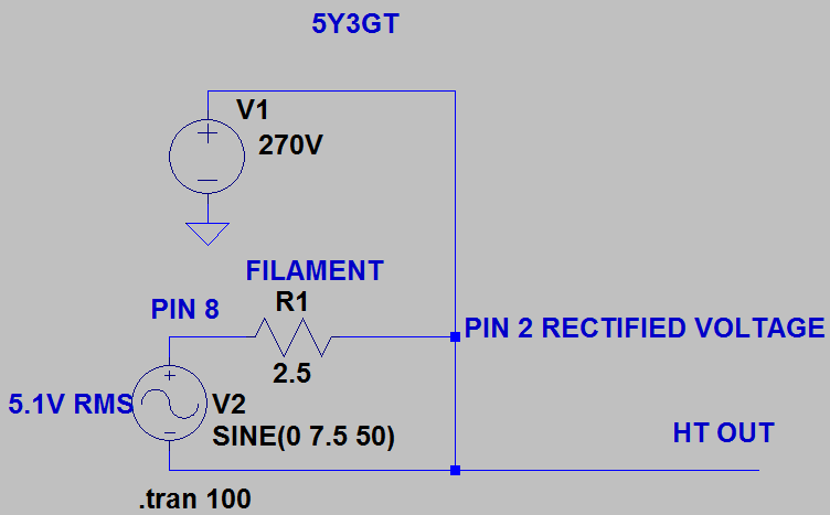

I have attached a picture of a 5Y3GT wiring diagram & also a picture of a quick LTSPICE simulation of the same valve to try to understand a bit more on this.
In the picture of the Simulation, V1 is the Rectified DC voltage from Pin 2 on the valve, R1 is the Heater Filament.
V2 is the Heater Filament supply voltage 15V Peak to Peak--5.1V RMS.

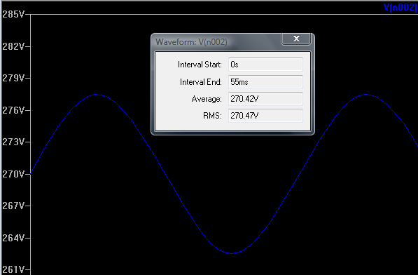

When I run the simulation I still get the 15V peak to peak signal but now the RMS voltage is around 270V on PIN 8 of the valve.
I am a little confused with this?
Ok, this is still a 15V peak to peak voltage but the RMS voltage is a lot higher than the 5.1V?
Could someone explain this for me, am I just looking at it all wrong or do I have the simulation etc all buggered up?

Thanks hidnplayr,
I think the problem I have is just a lack of full understanding at this stage.
I think you have just answered my question with:
"The 5V supply is at +270V potential."
Yes. I see what you mean, well I think I do?
If I had say 350V RMS at pin 8 then I would still have the 5V supply but at +350V potential.
Is that correct?
Cheers
Yes your 5V supply has 350VDC superimposed on it but there is still only 5V AC applied to the heater, that is why there is a separate winding on the transformer for it not to mention AFAIK only directly heated valves use 5V heaters. In the days of valve televisions the heater of the 1S2 EHT rectifier had 15KvDC imposed on its 1.4V heater.
