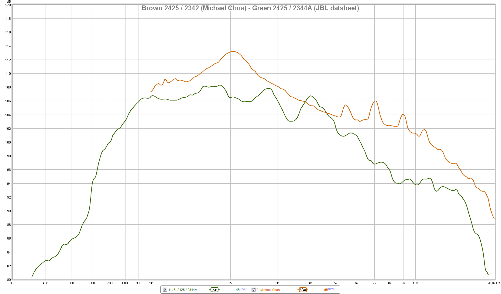

But I think your 2425 might be messed up (or the meas system isn't being used correctly). 20dB rolloff to 17kHz doesn't seem reasonable.

I think you're right, something must be wrong. I've used LMS for many years, so I doubt my technique is the problem.
I will swap the 2425 with another driver to see whether it still exhibit the same slope.

Couldn't find data 2342 horn other than a picture where its mounted in cinema speaker system and from that picture it looks a lot like Bi-Radial 2344A.
At this link (2344) is JBL official data 2425 mounted in 2344A (look the non EQ one) and that looks not so crazy different from your own posted measurement if that is also without any EQ.
In below REW overlay plot traced your 2425/2342 and that from JBL 2425/2344A datasheet and it seems those Bi-Radial horn need EQ : )

Thanks for taking the time to check it out. I'm relieved. For a moment, I thought there's something wrong with my 2425 drivers.
My measurement was without any EQ. You're right, it looks very close to the 2344A. So there's hope.

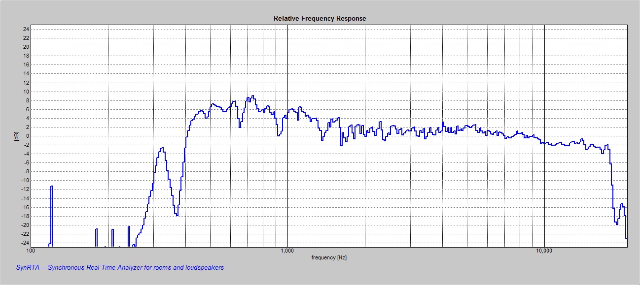

POOH, that is almost hard-to-believe low end for such a small driver... 500Hz? I don't have any easy to try horns that go that low (without taking something else apart, which would be a mess). That's not boosted on the low end at all? Can you post a photo of what your horn looks like? I'd be curious about how the distortion of the driver does at lower frequencies at, say, 90dBSPL or so, might be worth ripping into one of my old wood horns to find out.
BTW, I think JShadzi was saying that the response without EQ on the drivers will sound as if it IS boosted in the 1k to 5k range (not how to EQ it). At least that's how I read it.
It's a big horn - like this
Community Fiberglass Horn Lens 1" Bolt on Single w O Driver Clean See Photos | eBay
I am using a resistor and cap to pad down the midrange attempting to use it in a 2 way - no eq on the low end.
