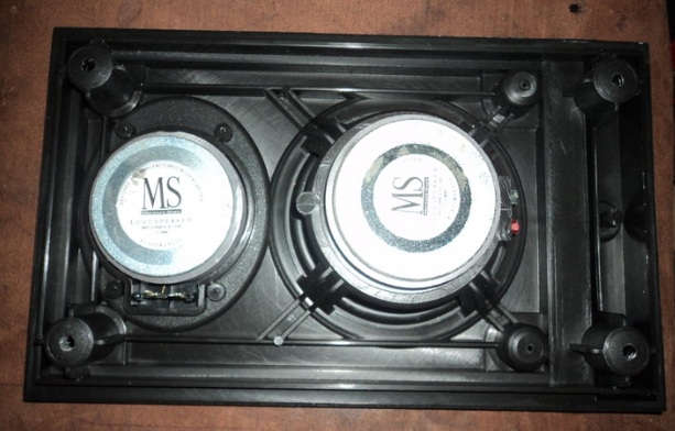

Hi Guys,
I purchased a pair of ms10i pearl addition speakers from ebay and upon testing unfortunately found that one has a blown tweeter so I am wondering if someone could recommend a replacement tweeter as I know it is of a fairly common spec being an 8 ohm 25mm aluminium Dome.
I am on a budget with this project so do not want to spend too much.
I know some cheaper tweeters can sound harsh but the spec of the ones in the below link sound quite good and am wondering would they do the ms10i any justice?
Black 50w 25mm Titanium Dome Tweeter 8ohm - CommsAndSound.com
Any advice would be much appreciated as always :)

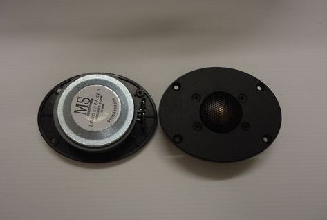

With the rectangular spacing of the domes screws
nothing is going to fit the standard mounting plate.
So your going to have to cut down a round tweeter.

The model number on the rear of the tweeter states:
91000899306

You just gotta figure out how to get them to fit. I'd give the broken tweeter the 1.5V battery crackle test first. It might not be totally dead either. Might just need a teeny weeny wire resoldering.

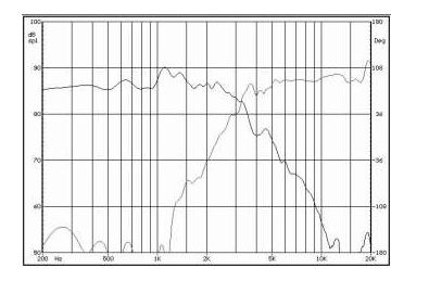

I'd reckon it's worth fixing the MS10i. Nice plastic bass unit. You should measure its DC resistance first to establish if it's 3 ohms DC (4 ohms nominal) or 6 ohms (8 ohms nominal). Then can sort out a crossover upgrade too, based on the more sophisticated 4 ohm plastic bass Epos ELS-3 which was in the Robin Marshall stable. First order kinda sucks unless you like BRIGHT. :cool:
Nothing hard about this.
