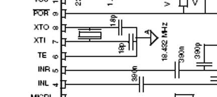

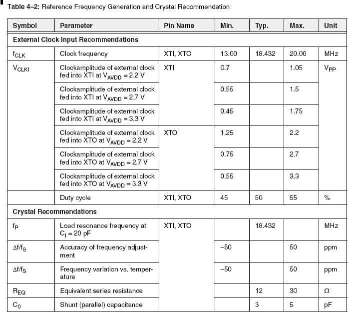

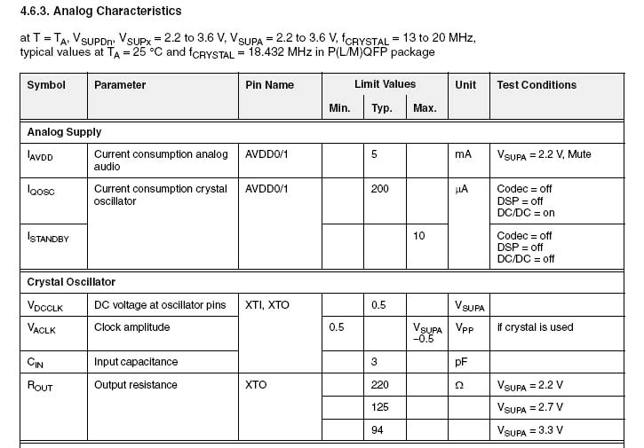

Hi!
I am currently using squeezebox ( a music server from www.slimdevices.com) and it uses a Micronas MAS 3539F for most of the function. This chip actually uses a 18.432 MHz clock and I wonder if replacing this clock with a external one like tent clock/kwak clock will reduce gitter and improve performance. I have some ideas already but would like comments on the voltage that the chip can tolerate.
Attached please find the excerpts i cut out from the datasheet
