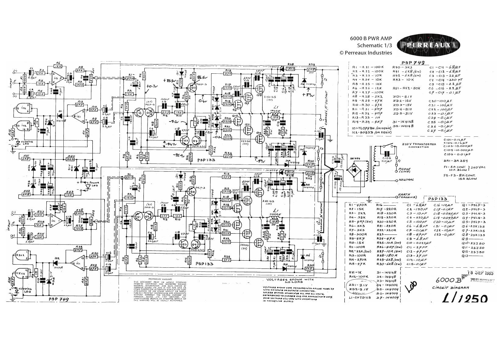

Thank you
Hi Eric,
Thank you for responding, I was able to get a schematic from Perreaux, which i will post here soon for others who might need it.
If I may ask a question, one side of my 6000B starts to clip and the red clipping light comes on, the other side goes all the way full with no problems. the clipping side is still pretty darn loud and clean till a certain point. Would you have any suggestions for that cause?
I have ordered new electrolytics for both sides, and have been reading over several times this thread with your tips and am very thankful for that.
Thanks again for responding,
Eric Pinson

Replace the caps and see how you go....
Funnily enough, I have a 6000B on the bench right now and have just replaced amp board input cap (10uF 63V) with a non-polarised electro and replaced the dc unity gain cap (220uF 63V) with a low esr version and the amp now sounds a little cleaner.
Next step is to replace the electros on the balanced input board with new.
After that I will desolder all amp board wire connections, remove four bolts per side and remove both modules for the blanket resoldering/cleaning operation.
After that is to tin all wires leaving a blob of solder and then sweat the wires back to where they belong on the pcb.....better than brand new amp !.
If you could fling me a copy of your 6000B manual that would be much appreciated.
Regards, Eric.
