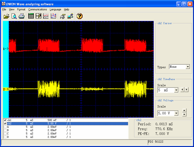

finneybear said:More gossip, about the good sound of DAT machine Sony PCM7010.
The high spinning speed gives the drum a high moving mass, the high moving mass goes to smooth rotation speed, and in turn, the read out bit data has relatively low jitter.
You are a great dreamer!
The jitter direct from the heads is the order of 10us (micro seconds). Here, with the PCM63 LATCH, we are talking about 3 ps (pico seconds).
Please, next time before you start the bragging again, at least do some math first. 10us jitter? Let's see. DAT can do 16bit/48KHz. 1 second /48K = 21us. 21us covers 16 x 2 = 32bit so each bit cycle is 656ns. This even does not include the lead/postfix track data.
Now 10us jitter covers 10/0.656 = 15 bit cycles. I am wondering how a DAT machine will ever work with a 10us jitter?
PCM63 LATCH has a 3ps jitter? What latch are you talking about? Where, when? And how did you measure it? What makes you come to this conclusion? I am sure TI/BB engineers will be really eager to know. Probably just another good laugh for us under the grape vine?

This is what I said. Dispite of the 200 ps clock (which is realy poor), the DAT sounds good! I agree!
Sorry, I ment 10 ns (nano seconds) stil 3000 times the values found at the LATCH of a good reclocked PCM.
