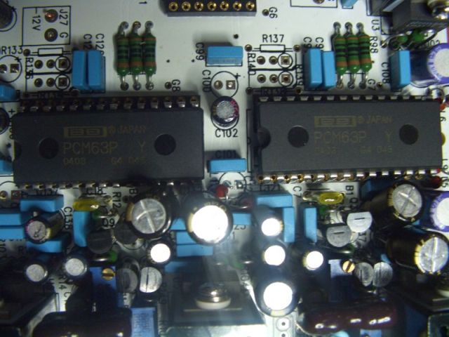

After some listening to various combinations I've currently got 3 and 6 installed as a pair. 7 is on the other channel so not an option.
After spending time listening I'm convinced the HD figures only come into play at quite high levels. 5 wasn't an obviously bad chip just very fatiguing to listen to. 4 looked like it should be the pick, but there was something not quite right about the sound - a slight "ear pressure" similar to what I experienced with the K's. As can be seen in the spectrum the noise floor on this chip is elevated from the fundamental out to 4Khz or so when compared with the last 2 chips.
My take is that the noise floor is the key determinant in a chips sound providing that the harmonic distortion levels aren't extremely high. From listening to the amped clips of the chips, I can't detect definite harmonics, except in the case of 5. There might be faint harmonics audible in 3, but if they are there they are only at the margins of audibility. Based on the worst harmonic of 3 this would suggest that somewhere between -115 and -116dB is the limit at which the harmonic peaks have cease to have any possible audible significance. This is about the same limit Bob Katz claims for a properly dithered CD.

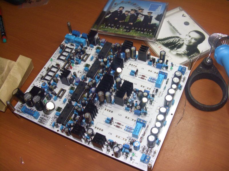

D1V3 in Progress...
Yes, indeed. I am working hard to make the DAC sounds. I just connect the power supply cables at the bottom D1V3 pcb when I read your post, IY. Many thanks to remember me; your posts always got me interested. I am not far away from the hot iron
I am always following this thread everyday with great attention. I want to learn more from you guys, and hope Paul will not quit since his contributions were very interested and reading to his opinions is absolutely worthy. Even with his efforts to give all of us the measurements of his equipment, give his best to this thread.
Paul, after I read your post at http://www.diyaudio.com/forums/showthread.php?postid=1477744#post1477744 and http://www.diyaudio.com/forums/showthread.php?postid=1466231#post1466231
actually make me interested to buy tentlabs product also. And I know that you are not promoting for this particular product when you posted the threads. So I will try it someday and of course the other method suggested by Spencer using DIR9001. I will decide what the most preferable to my ears, no matter that method was promoting or not by someone.
So please don't quit Paul, we are still looking for your post, hopefully in the near time. Thanks to all of you guys

Noise is just noise.
I don't think so. Several of the PCM63K's I have showed significantly lower HD than several of the PCM63P-Y I had received in the first batch. According to your theory they should have sounded better, but they sounded much, much worse. The clear difference from the specturm analysis was a higher, "grittier" noise. Not a huge difference in noise floor, maybe only 3dB but the effect was clearly audible.
Similarly with the current PCM63P-Y I've been testing and listening to a couple that measure better in terms of HD but sound worse and the only thing I can see in the spectrum analysis is low level junk in and just above the noise floor of the FFT.
I don't understand what the junk and grit are revealing about the inner workings of the dac, but based on what I've heard the effect is audible. I'll take some small comfort in the knowledge that Pass Labs were selecting PCM63P-K for their D1 DAC's on the basis of noise and linearity, not just THD figures.
