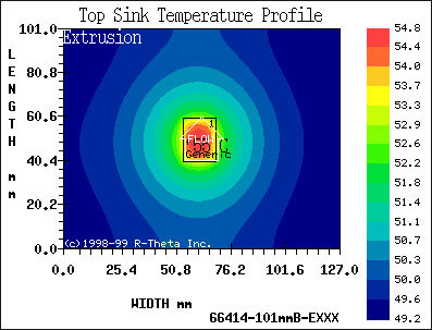

Hi folks,
I'm experimenting R-theta's heatsink simulator. It looks very poweful, but I would like to have the seal of approval on my simulation from forum's elders.
DATA:
- My chassis design (see it here) provides a 4"x5" heatsink (R-Theta extrusion# 66414...this is actually what I'm planing to buy) for each IRFP244 FET (Aleph2). Therefore, I've set up 25W of heat to dissipate per heatsink (300W overall...12 FETs).
- From IR's datasheets I've found out that the max. junction thermal resistance is 0.83 for the IRFP244
- I've use generic grease for the simluation, Rimp = 0.1 as suggested by the simulator
You can see the output below. Temperature elevation seems not too bad...this is in fact why I'm doubting and asking your advice.

Here's the result:

Somethings up with the program if it's telling you that you'll end up with a junction temp of 55ºC..........
if i've got my facts correct,
25W per device
each device has it's own heatsink
each heatsink is rated 0.82ºC/W for 100ºC rise .... about 1.134ºC/W for our puposes
and we need a electrical insulator in there too.
So,
Ambient = 25ºC
25 x 1.134 = 28.35C (heatsink)
25 x 0.75 = 18.75ºC (electrical insulator + 2 layers of grease)
25 x 0.83 = 20.75ºC (case to junction)
So, Junction temp should be up around 95ºC for the outter devices and probably about 110ºC for the inner devices....
Now, looking @ the datasheet,
@Tj = 110ºC, irfp244's are rated @ 75W and 215V
Alright, I had misunderstood the graph. This is only simulating the heatsink...55ºC (58ºC at 23ºC ambient), is the temperature at the middle of the heatsink not at the junction of the FET. Still, the temperature of the heatsink itself will be pretty acceptable and this is what I was trying to figure out.
Looking at the written results, the simulator is stating (for 23ºC ambient) 97.4ºC exterior (case) and 118.2ºC interior (junction). Is 118.2ºC too much (acceptable) for the FET (max. 150ºC). I know it will influence the FET's life, but is it critical? What would be the ideal temperature range?

That's probably going to work out too high as the internal rows of fets will be in an ambient of about 50ºC and that's assuming that the ambient in the room never exceeds about 25ºC while operating the amps.
assuming best case situation, if all fets had case temp of 100ºC and junction temp of 120ºC,
IRFP244 are rated @ 60W and 210V.
more likely is that the outer rows of fets are close to the above temps and the inner rows are 30ºC hotter. case temp of 130ºC and junction temp of 150ºC,
IRFP244 are rated @ 24W and 200V.
If that is the case, those devices will fail very quickly.
The point is therefore to improve the thermal conductivity between the FET and the heatsink. There's actually two variables: (1) the two layers of grease and (2) the insulator.
1) Digikey sell grease with 0.05ºC/W per 0.001" layer.
http://www.wakefield.com/pdf/Accessories.pdf
2) Digikey also sells mica insulators:
"These precision stamped MICA Insulators provide good thermal conductivity (.009 watts per square inch per
°C per inch in thickness". These are 0.003" thick. Thus 0.33ºCin²/W~0.33ºC/W
This brings down the thermal resistance for the insulation from 0.75 to 0.43; 0.43x25W=10.8ºC which is not really enough; still 85ºC at the case and 100ºC at the junction.
Is there better insulator/grease out there? I really need the best to solve this problem.
Furthermore, one unknown at this moment is the heat dissipation done by the casing and supporting aluminum bars. I'm quite sure this is not neglectible. Combined with a massive venting (for the inner rows of heatsinks) I guess I could give it a try, build the thing and run a real life simulation. This will be the only way to have the real answers.
Once again, what would be the ideal temperature range? Is 100ºC at the junction acceptable?
best regards,
Gabriel
