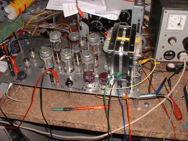

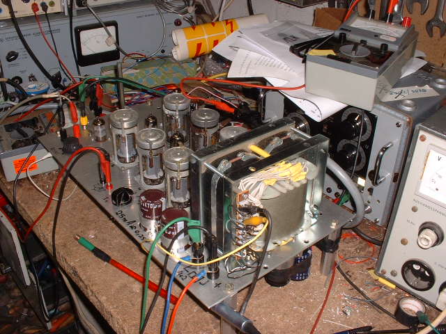

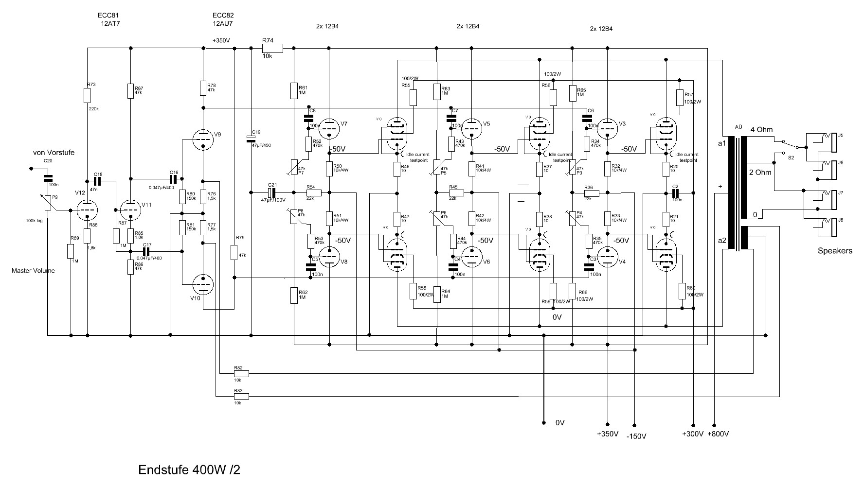

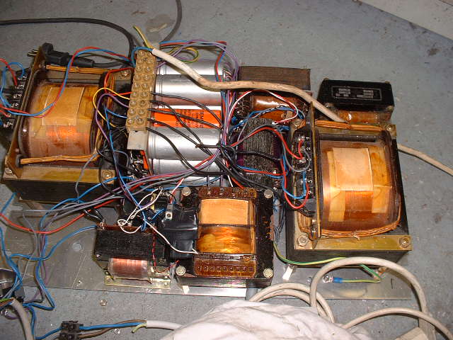

Hi All,
I recently made a breadbord Power amp for some examitations, especially with the grid currents. To estabish the facility for an individual idle setup for each valve, it is neccessary to use an separate drive valve for each opt valve.
I use six 12B4 valves which I had between my odds and ends. A widely makeshift power supply deliver the different voltages as there are 12.6V @ 6.5 Amp for the GU50 and 12B4, 6.3V @ 0.6A for the 12AT 7 and the 12 AU7, -160V g1 Voltage, + 250V g2, +400V input/phase split/ driver and +900V plate via variac.
The opt is also homebrew. It is a SE150a split tape core rpp 2,2k / 400W, 35 Hz/-3dB.
Some values in the circuit diagram has slightly changed while working on the amp.
The results of the last test delivers 440W into 4 Ohms ,the plate voltage drops down to 840V. The THD is 6% , 1 kHz
The grids of the op valve driven up to 20V peak. The idle current is set to 35mA. The input for full blast is 500mV. In this setup I feed the grids and screens via lab power supplies, not to see on the piccs.
Some suggestions for improvements and comments & crits are welcome.
73
Wolfgang
Here are some pics of the setup:
  • Endstufe-2-1.pdf

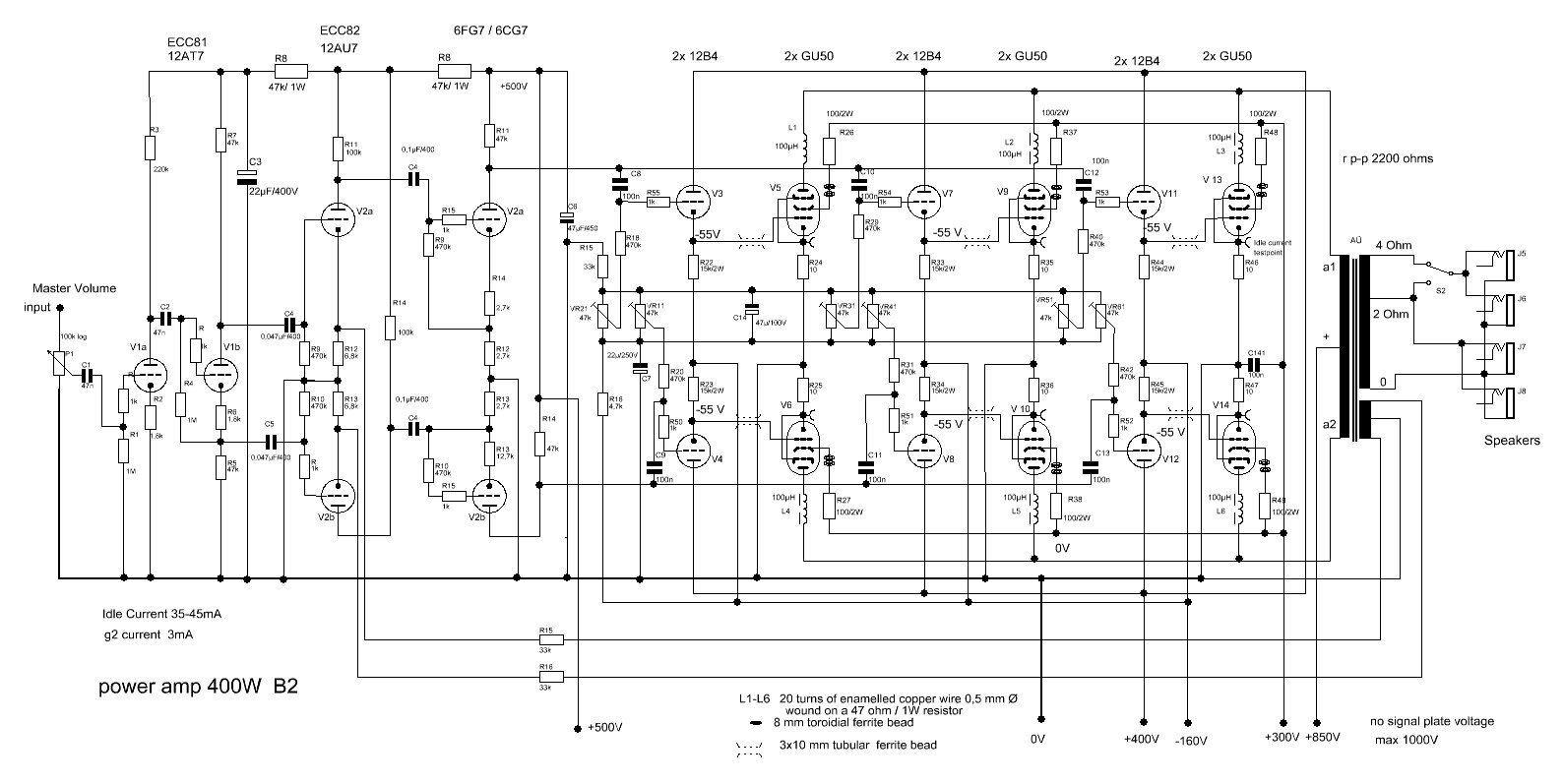

Hi Funker.
Compliments: Nice circuit - I like the driver setup - pretty elaborate but I give you it does enables precise setting of each power tube bias in a much better way eliminating the need for selecting the tubes - which I have to.
The symmetical NFB is a nice touch - I probably would have used the sectons for cathode feedback on the power tubes instead. You decrease the effective damping factor by the loss in the OPT core not taking feedback directly from the speaker section but looking at the core size used it is probably negligible anyway.
I recently published a circuit using symmetrical feedback in a mixture of voltage and current feedback taking into account the MFB from the speaker coil itself. Works beautifully with large diameter woofers. Food for thought, maybe?

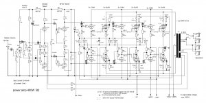

Hi thebasher,
due to grid current drive , there are a great amount of THD at high output levels. The tight coupled balanced nfb reduce these amount of THD drastically.
At my first considerations I would leave the output floated. But now my decision is to establish a second nfb from the speaker terminals to kathode of the input valve.
Another change is alredy done , I inserted a adiddional stage with a 6CG7between the 12AU7 and the six 12B4. The the gain of the 12AU7 is lowered by increasing the both kath. and plate resistors . The additional stage extend the maximum output swing from 50Vrms to amazing 80V rmas. So now my driver circuit got enough headroom without the risk to be overdriven before the output stage reach its maximum power.
The driver supply is now 500V. My experiences are still ongoing . My last test bringing 450W with 4% THD. The frequency range is from 30-15000Hz at Full power and 20-20000Hz with -3dB at the bandlimits. The grids are positve driven up to +20V peak.
Here are the latest schematic.
73
Wolfgang
DF6ZC
Edit.
There is no way to put a better schematic quality into this post. I tried pdf but the programm say to much data. The original schematic is drawn with S-plan!

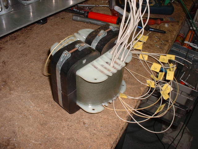

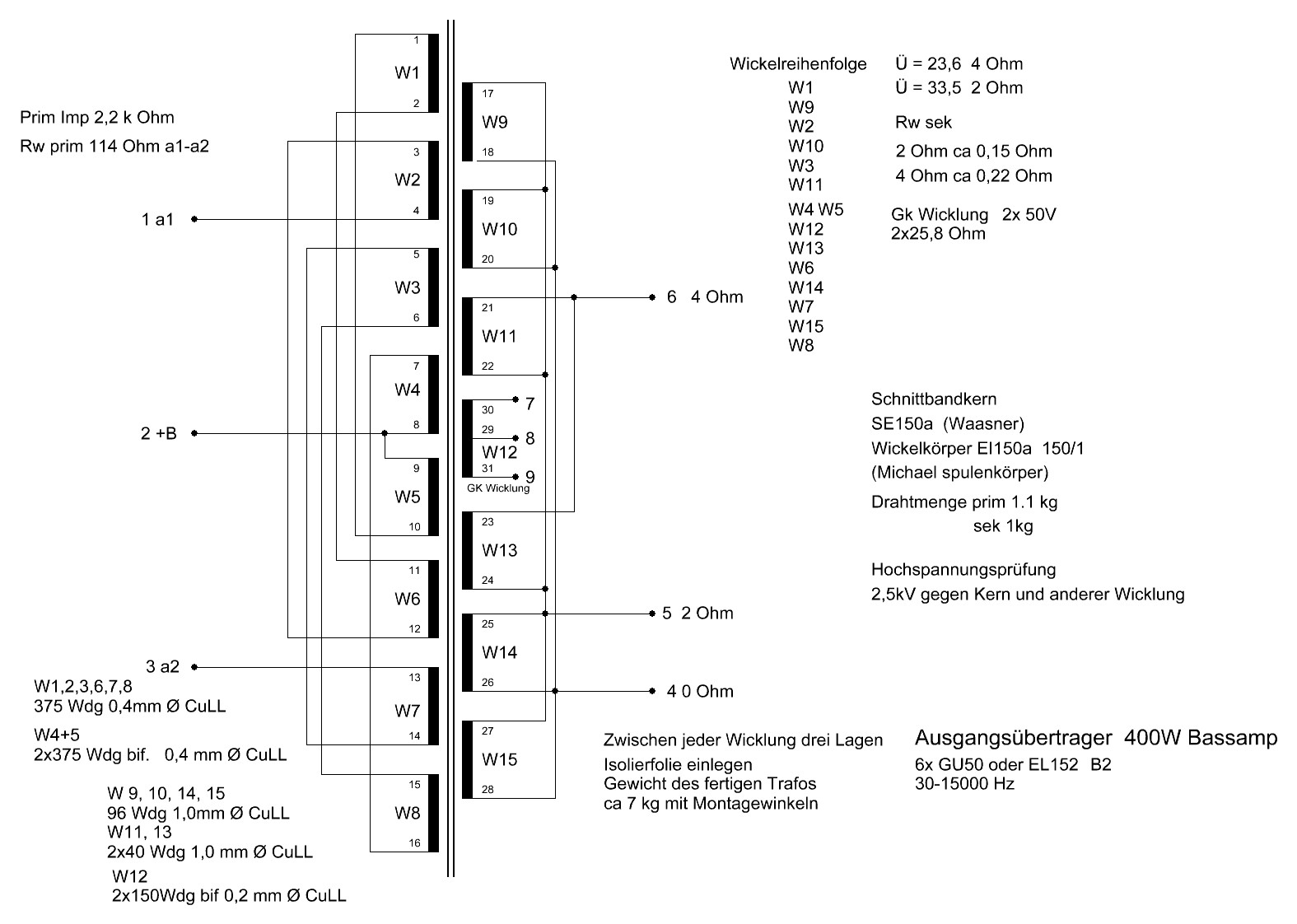

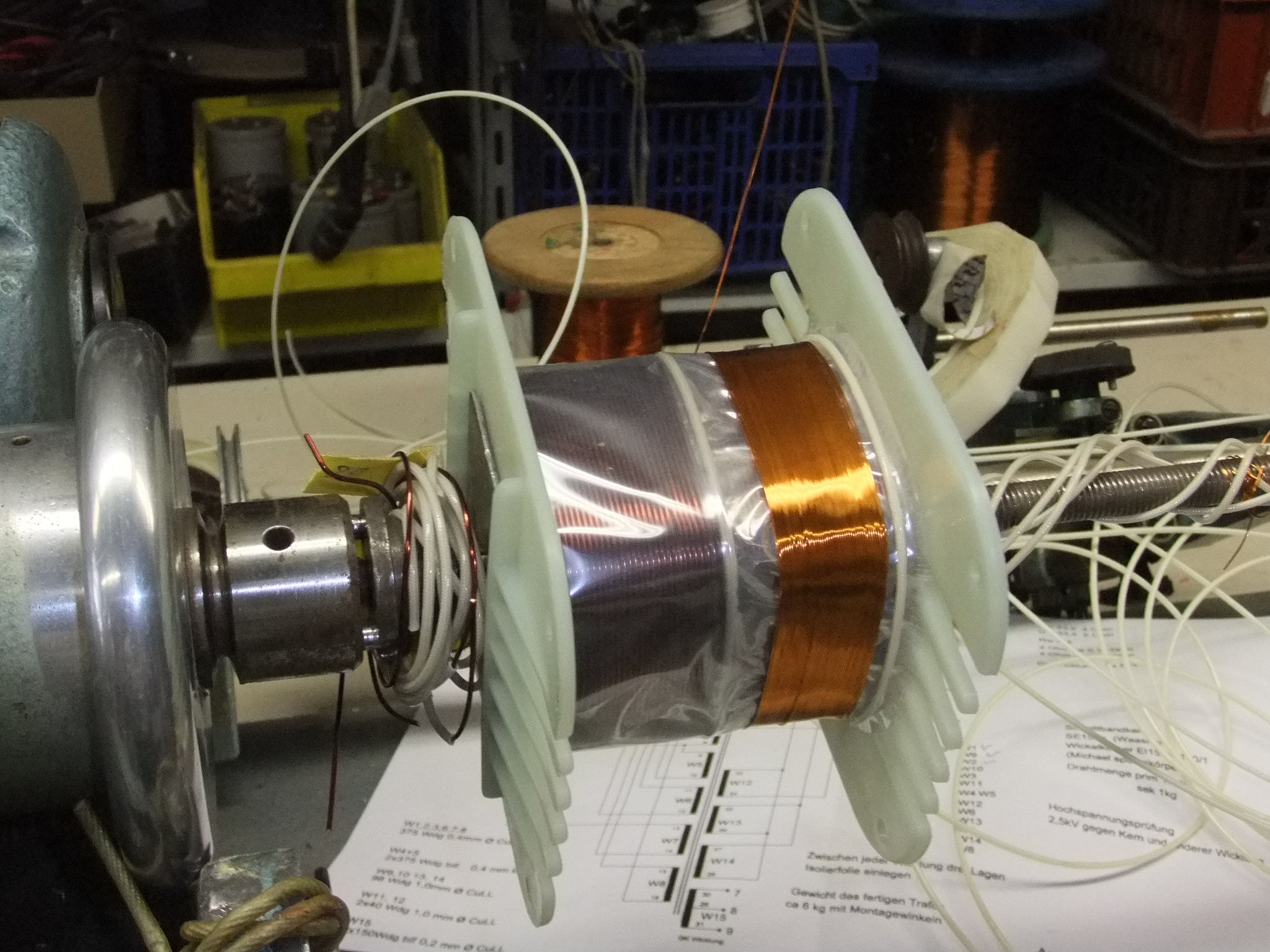

Hi Funker,
can you give dimensions of your C-cores and how much the iron weighs? thanks....
Hi Tony,
The Transformer is a DIN standard C core , SE150a , weight is app. 3.3kg
it need app. 2.8 kg copper wire , the finished trafo with the mounting frame weights 6.5kg.
Here are the winding scheme:
73,
Wolfgang

Hi thebasher,
your circuit is high alert :D
The current NFB is a great idea to compoensate unwanted speaker properties. I know the old Philips NFB self powered speakers. As they are, yes they sound very good, especially for their size.
But on the other hand these combined voltage/ current feedback give its advantage for only one speaker setup which has to be precisely adjusted.
If the amp should work with some differnt kind of speaker it would be the best to obtain a low source impedance of the dedicated amp.
Since the NFB loop now include the speaker, the amp and the speaker are to seen as one unit and the only way to measure their properties with appropriate test equipment is by using a test mike instead feed the output voltage of the amp to the test gear.
In my case, this amp shall be the output stage of a Bass Guitar amp. As I sad a Bass amp , a low THD is not the aim. I want huge Power output as it bring this sort of grunt the rock musicians are really like. The amp is intended to operate with an 8 speaker bass cabinett, maybe fitted with 10" chassis. For instance, it may be possible to place the potmeters for the both voltage and current nfb on the back of the amp. But I cannot believe that an Musician is able to find the proper settings to a certain cabinett.
With certain settings you might damge or even destroy the speaker(s) or the amp. So this kind of controls belongs to the inside of an amp away from curious musicians hands.
I will keep your circut in mind if I would once building self powered monitors with valves .
My current monitors are K+H O98. I use the wavelab sound processing software from Steinberg with an M-Delta 8 Channel sound interface and a RTW Peakmeter.
Thank you for your input
73
Wolfgang
wow, that looks smoooth :rolleyes:
hmm, any reason not to split the clear tape before winding the thin wire ?
looks like it crumples a lot
it might not if cut in the middle
but whatever, it looks cool
Hi tinitus,
the thin winding you see is the nfb coil. The next layer is another clear Tape, followed by another thick secondary layer.
Normally I should use a thinner foil, but I didn´t had that. And If I would cut it into two halfs the edges would form a recess an thats aggrivate to bring the wires straight onto the coil former.
73
Wolfgang
Well, I think the amplifier shown in #25 has neither MFB nor negative feedback, given by the shunt resistor R25. Current driven NFB would decrease the output voltage if output current rises, in other words, it would increase the output impedance. This would not be beneficial at all! In fact, we have current driven positive feedback here, in order to decrease output impedance. In the mid-fifties this kind of circuitry was "en vogue" in Germany. The then well-known FUNKSCHAU magazine showed many examples.
By chosing the right feedback factor, we can reduce output impedance dowm to zero - and far beyond! And this is exactly the problem Funker describes above. Output current strongly depends on load impedance, and as we all know, a speaker's impedance is not that constant. So in fact it's almost impossible to adjust this feedback correct - even if only one certain speaker is intended to be used. Thus the lifespan of this circuitry was rather limited - it disappeared as quickly as it arose.
