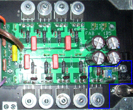

See attached picture of the pcb with the "current displacer" within the blue line area

Hi Fab,
Your project and results are very interesting :cool:
And, thanks for the info about Class XD and Displacer.
BTW, in connection to Fig.5, the additional SE bias, I'm reading Aleph 0s output and its SE CCS bias . . . (for me to try for my F4 hopefully soon) . . . And, I'm wondering where the "ISD" is going to? Do you (or anyone) know about this?

Fig 5 doesn't have an Isd, but referring to that figure, at idle the
current which passes through the constant current source comes from
the current going from the positive supply through the N channel
output, through the current source to the negative supply.
For positive output current, the current source continues to get its
current through the positive output transistor. For negative output
current, it will start to also draw from the load, and at some
sufficiently high negative output current, it will draw entirely from
the load as the positive output shuts off.

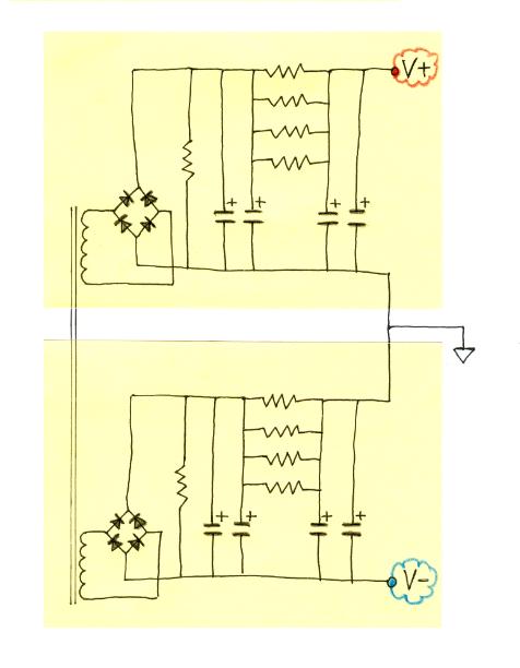

I'm going to try to modify (improve?) my F4 with two things:
  1. Power supply (change in small detail as shown in the attached sketch)
  2. Installation of the additional SE bias ccs
    [/list=1]
    Thanks to your explanation, I would keep my confidence with the SE ccs which to be arranged between the output and the negative supply, and just try to decide what type of ccs.
