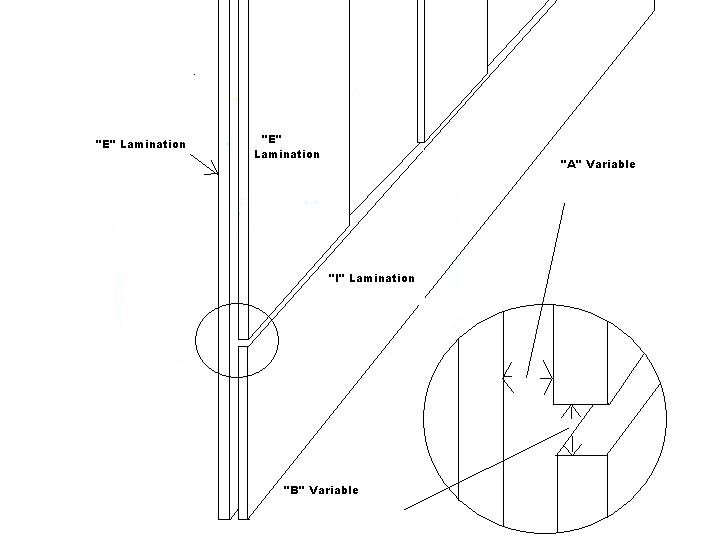

Spacings
OK.....I'm confused here now, are we talking of the spacing between laminations of the E I assemblies or the butting up of the E I sections?
See A variable or the B variable (See attached)
_____________________________________Rick.........
It presumes that you are stacking all the eez and all the I's seperately. Generally e's and i's are interleaved... and the transdesing for worst case minimum gaps...
In a gapped SE transformer the "E" laminations are stacked together, and the "I" laminations are stacked together. The "E" laminations are then gapped from the "I" laminations with a non metallic shim. Non gapped P-P transformers usually have the "E" and "I" core sections are interleaved as in the diagram from Richard Ellis. The laminations are often coated with a varnish and vacuum baked which may make them hard to separate. The better quality transformers often have more varnish, while cheaper ones may not have any at all.
I have successfully taken a P-P transformer apart and restacked the laminations as one big E and one big I. I then tested the transformer as an SE transformer with 3 different gaps made from one, two, or three thicknesses of masking tape as the shim. In my case two layers of tape worked best. I started with an "80 watt" P-P transformer that was made for guitar amps and wound up with a SE transformer that could handle 5 to 10 watts depending on how much bass I wanted. I would say that the result sounded better than the $19 Edcor or the Hammond 125CSE, but not as good as a "real" SE transformer.
