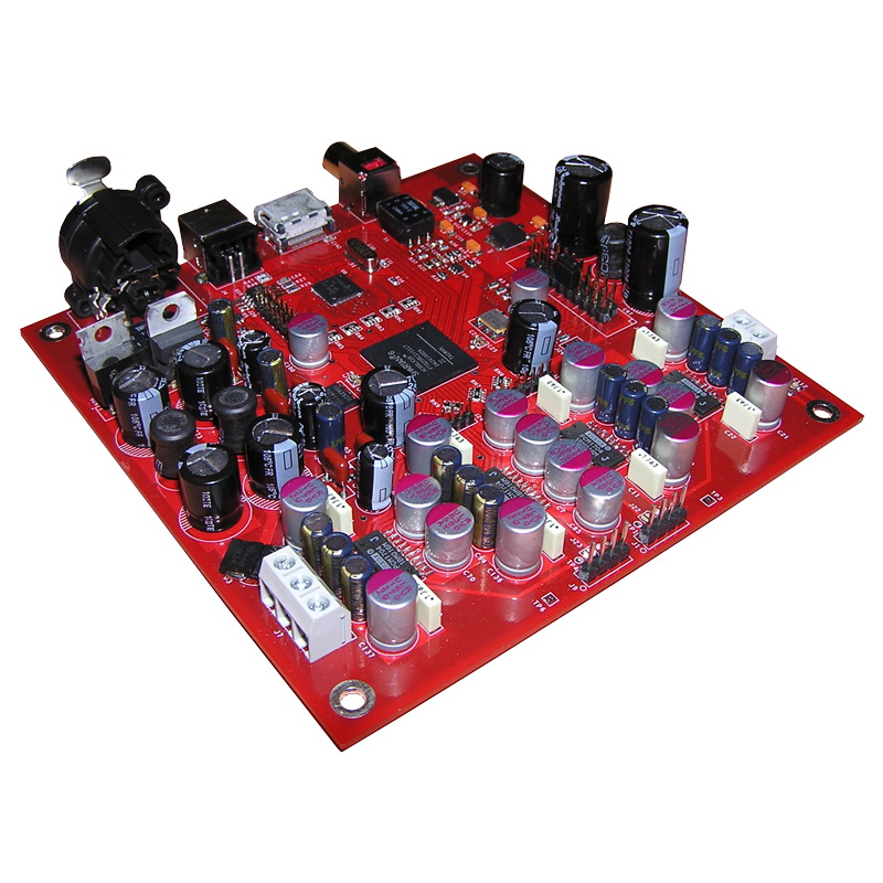

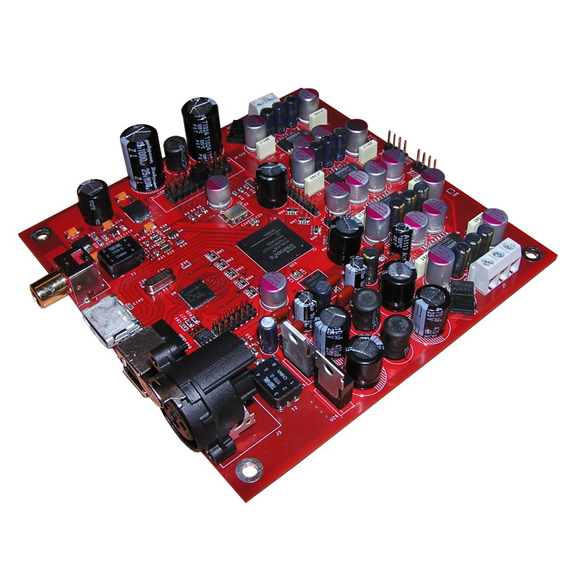

We all know how good a PCM1704 can be. Currently priced at 75$ per mono chip, and it seems to be the only 24bit R-2-R “dinosaur” available. I wanted to give to this chip that well-deserved digital front end, with a reclocker that offers superb jitter rejection(asynchronous FIFO style), a powerful digital filter, I2S, S/PDIF, AES and USB inputs (all accepting HD audio), convenient user interface with alphanumeric display and remote. I wanted the digital filter to be switched off when needed – for pure NOS operation. I wanted true balanced operation and this requires four PCM1704 on board. Could not stop it – I wanted the current outputs summed 2 by 2 for single ended output if needed – with the benefits of double current swing and double sample rate through analog linear interpolation.
The current outputs from PCM1704 are directly available, so any compatible I/V stage can be used, tube or solid-state.
The result is the RD30 dac, which took about 2 years of tests and bare r&d in all these critical areas to be completed. It is a very compact design, due to the fact that all the features are built into the powerful Xilinx Spartan6 chip XC6SLX16. Measuring only 124 x 125 mm and including all ultra-low noise power management and all input conenctors on board, only AC power is needed to fire up the RD30.

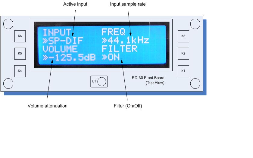

User interface options :
- control buttons + led indicators
- control buttons + alphanumeric display, 4 x 20 characters
- remote control (rc5)
Optional front panel board :
- type A : 4x20 alphanumeric display, IR sensor, control switches
- type B : leds for sample rate signaling, IR sensor, control switches

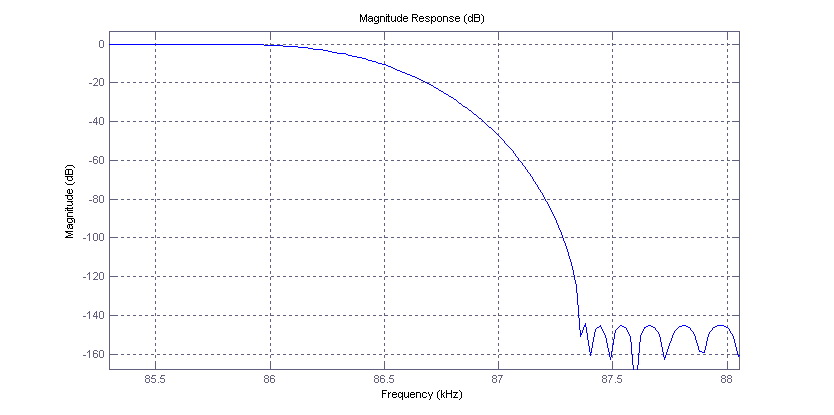

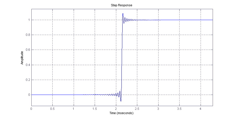

As promised, digital filter performance graphs in detail.
DF1 data:
Filter type : Parks McClellan linear phase equiripple
Taps : 1510
Input sample rate : 44.1k. 48k
Output sample rate : 352.8k, 384k
Stopband attenuation : -144 dB
Passband ripple : +/-0.00008 dB

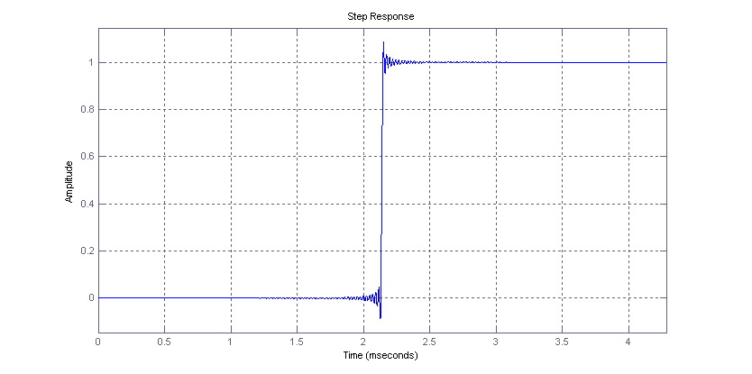

DF2 data:
Taps : 1510
Input sample rate : 88.2k , 96k
Stopband attenuation : -145 dB
Passband ripple : +/-0.00007 dB

Impressive set of features, well done!
I notice that the graphs in posts 13, 14 have switched places.
Any room left for different types of digital filters...minimum phase apodizing and the likes? Accesible via remote of course :)
Thank you Sidiy! You are right, I switched graphs, my bad :)
