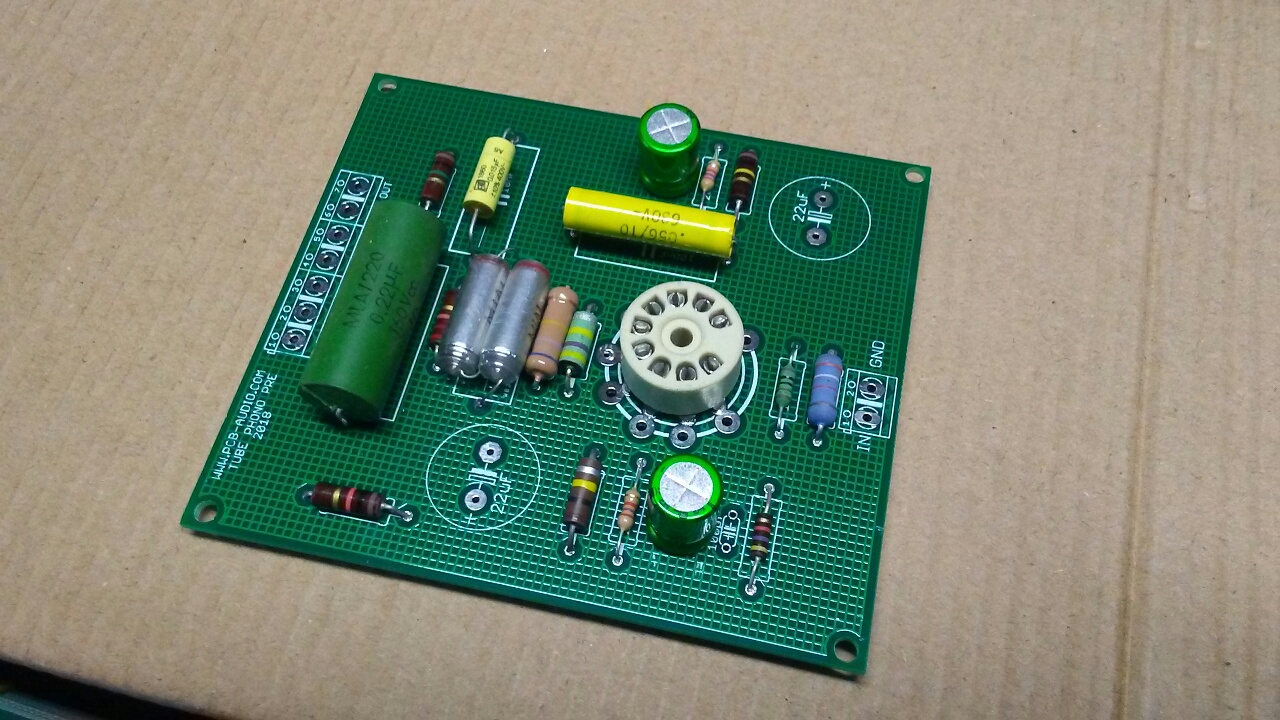

rca phono building
I'm also building this preamp and I'm very curious about how it will sound.
I am still confident because the rca electric scheme seems to me to be adopted by many manufacturers even if with small changes to the values of the components.
Hi from Chile Eli, i want to make this phonopreamp and i´m very interested in to do with your indication on this post but, i´m not sure how to do that, do you have the modified schematic for the final circuit?, please let me know and i hope your answer, thank you very much and greeting from ChileThe MOSFET buffer makes a world of difference. <snip>
