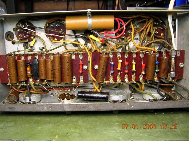

Wouldn't it be possible to remove the inners of the paper caps and replace them with new axials? Part of the old looks would be preserved.
Oh…I’d measure that burned R out of circuit. Looks very damaged to be within specs range.

The 300 ohm resistor simply has a black body. If you were here to see it in person, you would see it's fine and not burnt. Smooth and slightly shiny. I will be taking a closer look at every resistor and cap. I have a feeling this will take me a couple months of working and waiting for parts.
First I should lubricate the control bushings and do a proper job on this for the next person. It should still be in working order if I do my work correctly.
