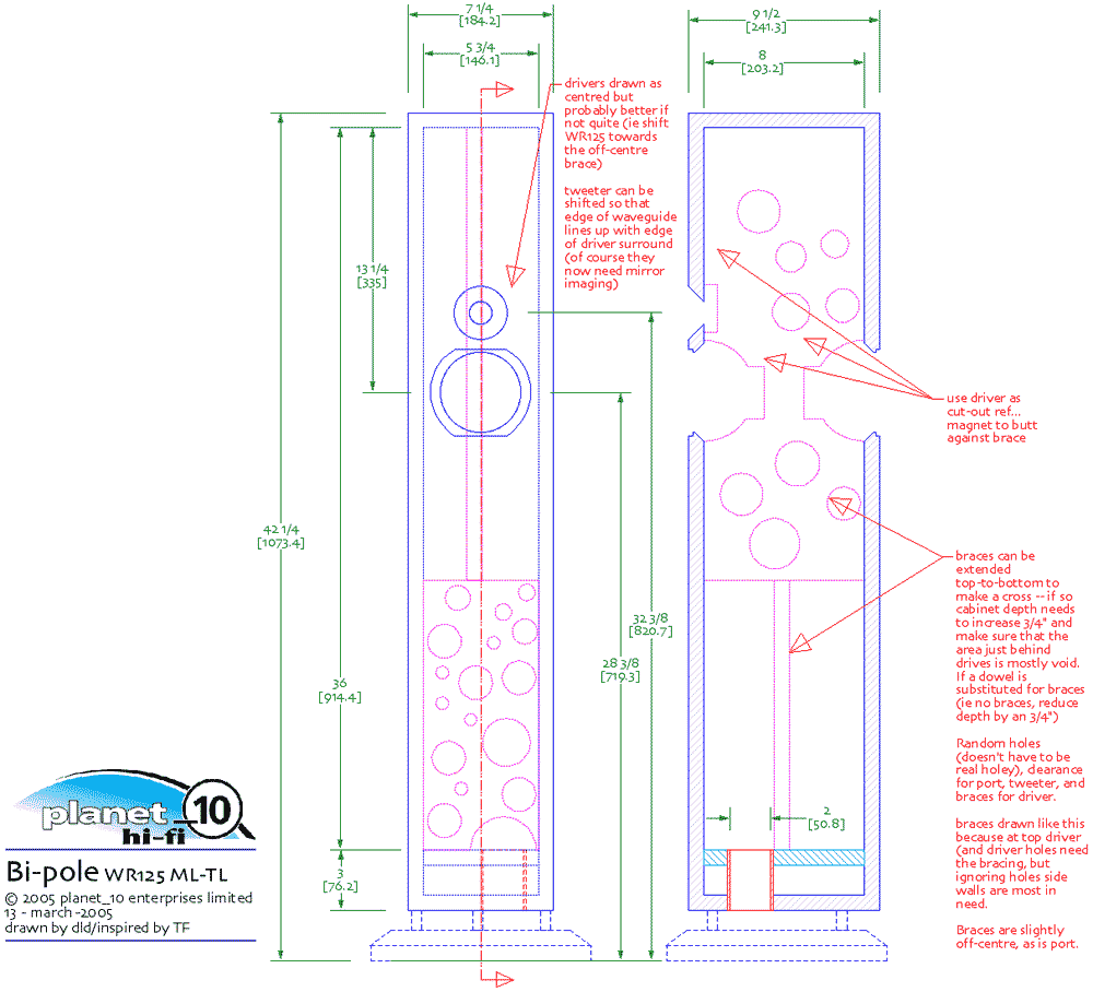

Which I assume means that a bipole WRS125 would be a lot better. I wonder why no one's marketing this, especially since there's a 16-ohm version. Has anyone tried it?
I came up with this and Planet10 and I have discussed a bipole version.

Scott & i are working on a prototype based on Tim's design.
dave
PS... i'll post a pic once i get photoshop working again -- back to panther we go.

Oops... forgot to do that.
