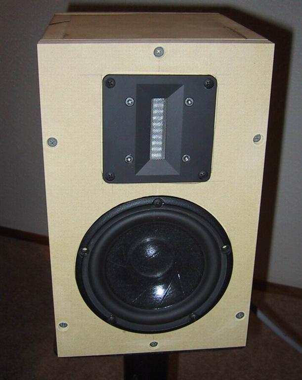

I have had these up and running for some time now, but
have never given a write up, so here goes...
Raven R-1 & Scan Speak 15W/8530 K01
Roughly 9.5 liter sealed
Rane AC22 active crossover
Crossed at about 3.6kHz
Driven by 4 channels of a Carver AV-806 amp
MIT Terminator 2 cables for Low
MIT Terminator 6 cables for High
Several comments:
1) The little 5 inch goes lower than you think. Most times I
am happier to listen without the sub than to tolerate
sub-satellite integration problems (is that a sentence?)
2) After listening for a few weeks, I think the Raven provides
very enjoyable highs. It also has a very strong magnet.
Cannot be used within 6 feet of a TV.
3) I believe these are the best drivers I have ever had in my
house. Both seem to be VERY good at what they do.
4) That doesn't mean that they integrate as well as I would
like. Still much more work to be done in this area!
5) I have not implemented the tweeter delay ( The delay in the
Rane is set up to slow down the lows, so I have to transplant
the circuit into the highs. Easily done - even explained in the
directions - I just have not done it yet.)
6) No measurements yet, and maybe not for a while.
7) I don't think the MIT cables make a damn bit of difference when
compared to Radio Shack 14 guage
8) No baffle step compensation or shelving low pass (yet).
Thanks for all the help guys.
