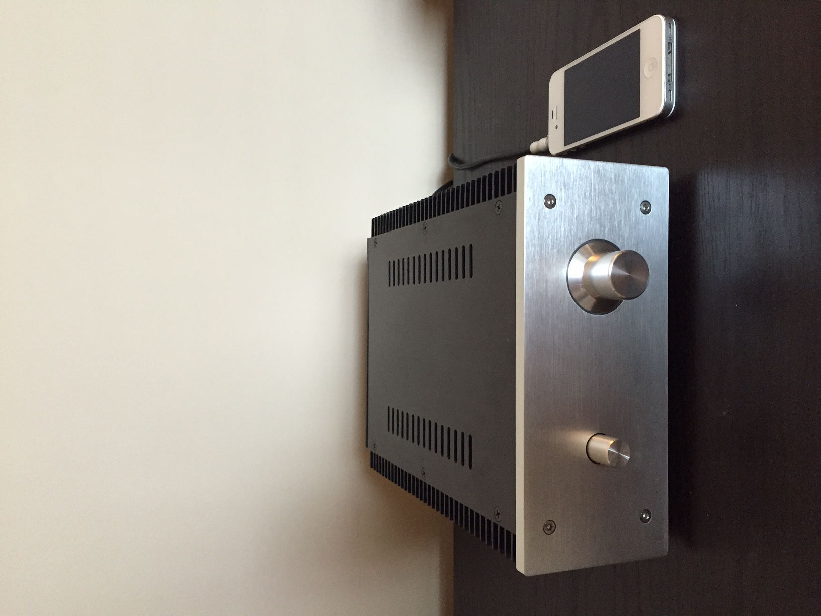

I am looking to build my next project to pair with my amp. I built a LM3875 premium amp from audiosector and the picture is attached. I would now like to improve the audio coming from the iPhone that I am currently using. I have a Raspberry Pi B+ and a Raspberry Pi 2 and am looking at the different DACs available for the Pi. I am wondering if it is possible to have the digital music from my iphone sent to the Raspberry Pi DAC and then to the amp and then speakers. In this case I would use my iPhone to control the songs and playlists.
Again, iPhone->usb -> raspberry pi -> raspberry pi DAC addon -> analog to LM3875 -> speakers
So, is this possible to do?
Alternatively, should I have a USB data drive plugged into the raspberry pi as well as a wifi tongle to connect to the internet. I could then use my phone to access and control the music off of the USB drive.
Finally, what is the best sounding DAC?
1) Hifi Berry Pro
2) IQaudio Pi-DAC+
3) Lucid Labs
I would also like to build an enclosure similar to the amp enclosure and have it sit either on top or under the amp. For power supplies, should I build my own internal power supply instead? I do like the internal look on this site!
