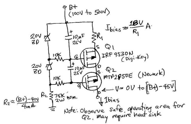

CCS
I only have this CCS scheme.
However I think I will be using Gary Pimm BMCCCS

If you add a CCS in the tails of the ECC99's and make them a diff pair, rather than PP, the LL1660PP would be fine, otherwise you'll need the 1635. To add a CCS (use Gary Pimm's BBMCCS) connected at the bottom of the -99 cathode resistors and run to a negative supply of about -40V.
