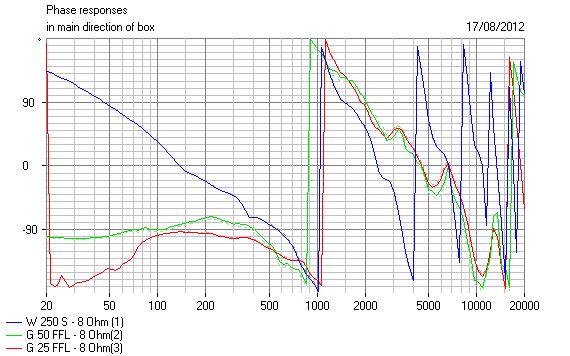

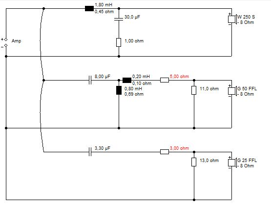

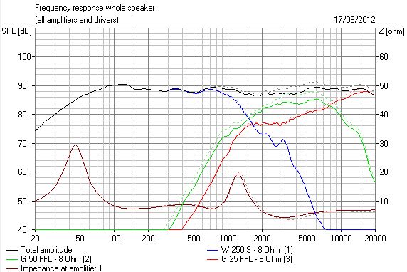

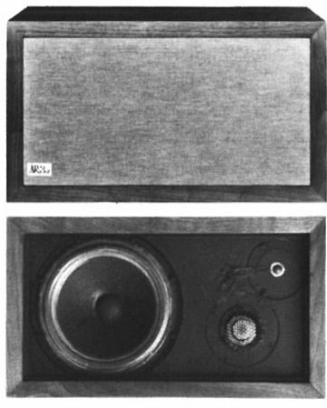

What I can tell you is these sort of domes were used by Acoustic Research in the AR-3A. It's really quite remarkable how well the filter and drivers worked together with an almost classic bell shaped profile on the midrange. I have slightly modified the AR filter for a crossover around 1.5kHz here. Despite the simplicity of the filter, response and phase is very good, and surprisingly my very rough sim with modern drivers (10" bass, 2" mid and 1" tweeter) gives no lobing above and below axis.
The strength of the lowish 1500Hz crossover is you avoid a lot of the bass cone breakup region. The 16 ohm wirewound level attenuators were an essential part of the sound, but I don't see why you couldn't use a cone tweeter. :cool:

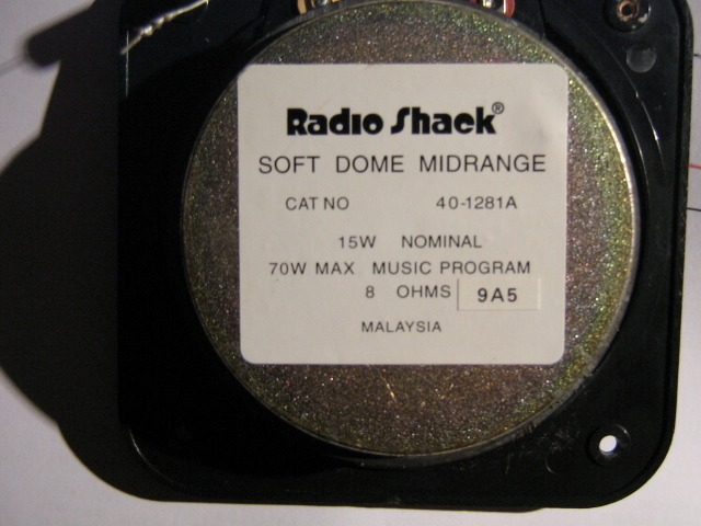

They came out of the discards bin at Tandy when they had their great big "Going into business with Woolworths" sale about 20 years ago
Part of their DIY line. Actually a reasonable looking bit of old kit, they even came with a wired on 10uF cap in line, but nothing like the high quality AR dome.
Rated 15 watts nominal program with the supplied cap, but by using a decent ( even a book ) second order XO I can probably safely cross these at 1500 and still carry as much power as the cheap 8inch woofers in the box
I'd use cone if I had a working one, but I have a spare cheapie dome.

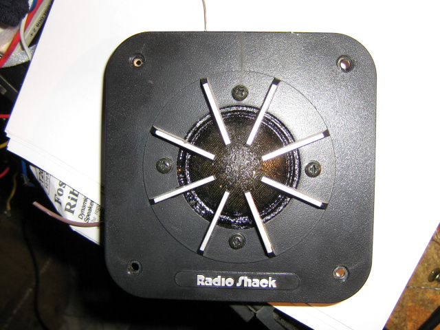

DCR is 7.9~ faceplate is 112*112mm

Dried out over 20 years, covered in cat hair and fluff too, does cat hair improve the response?
They are much better than the usual 3inch cone tweeter of the 60s and 70s which is what it replaced.
Has any-one ever tried improving one of these by drilling the pole piece out and adding damping? Looks like it would be possible

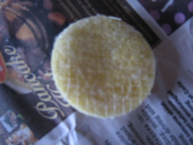

Rear chamber is 30mm across and 6mm deep, sides look to be 45 degrees, and I have no idea what the fibre pad is made from but it could be fibreglass.
Should I play or not, it is very tempting but I would have to drive 140 klicks to have these demagnetized before drilling and then the same again to have them charged up again. Same goes for adding ferrofluid but I can't find any suppliers in OZ and Amazon want $36 plus $9- for shipping and I imagine I need about a half gram or less in each VC gap. I am tempted to use a small felt pad in there tho, I have some (Somewhere) I used for tweeter mods a while ago
