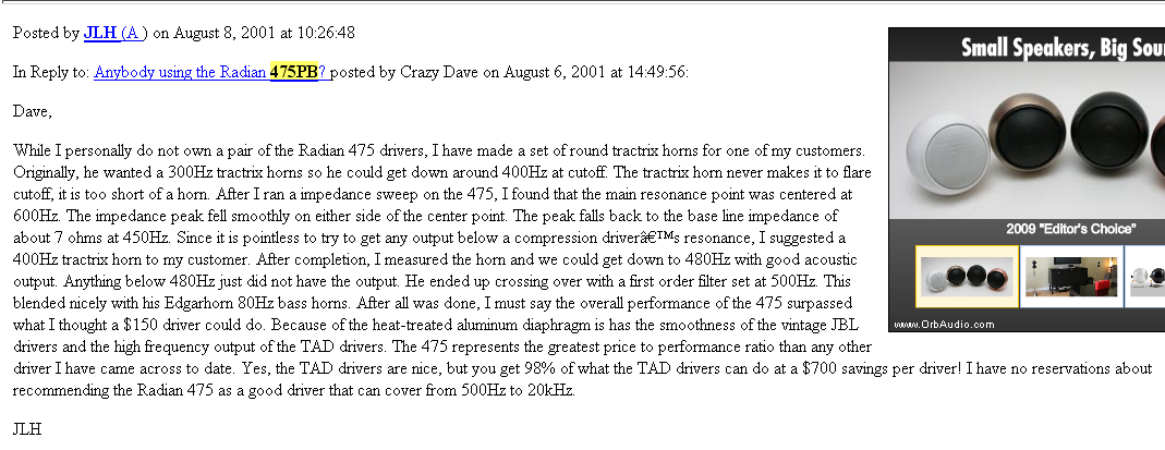

Radian has obviously bought the patent on the Emilar drivers. This driver as well as the 475PB is actually a brainchild of Jonas Renkus The only difference between the 3” diaphragm drivers is the strength of the magnetic force and the 2 different conical openings of the throat to either 1.4” or 2”. Many French audiophiles as well as John Hasquin consider the 475PB the next best driver to the TAD 2001. John has build many tractrix horns for his customers and says the the 475PB does 98% of the TAD. See attached screen-shot for his comments.

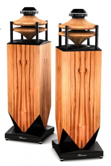

For you guys in the US, there is no need to search in Europe for good compression drivers that are affordable, you got it all there. Having the Yamaha JA-6681 as a 1.4”er and the Radian 850PB as a 2”er, my search for compression drivers is over. There is another product from Radian that I really tempted to try, the 5208 8 inch coax speaker that was used in the Galante Audio Rhapsody speaker. It got a rave review from Steve Rochlin over at Enjoy the Music. My wife is not thrilled about the looks of my all horn system and I must agree, it is only acceptable in a dedicated listening room. I am hooked to high efficiency and the next step down would either be a small appealing high eff. (94-96db) Coax or to build a 360 degree horn, in the likes of the fantastic Duvel series.

600Hz from a Radian 475 should be amazing sound. No need to go with the more expensive 1.4" driver for home audio which will beam in the highs more. He answered my other question too since Radian doesn't publish an impedance curve, the 475 has a low resonant frequency of 530Hz on a 400Hz horn. Most 1" drivers are closer to 800Hz. Are these quotes from another thread somewhere?
