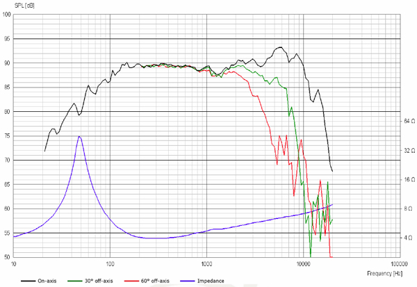

..and here is the "kicker":
The ScanSpeak 15W/4524T-02 clearly has the same problem, it's just a little lower in freq. because the driver has a larger diameter.
-and everything is a compromise, it's more a matter of choosing what is more important to a successful design (in the context of loudspeaker design), though generally as well.
You'll note that I don't have a problem with the ScanSpeak's surround resonance. Would I prefer it not be there? Sure. Because like you I'd prefer a more "perfect" driver. But it's not something I'd place so much emphasis and priority on this instance.

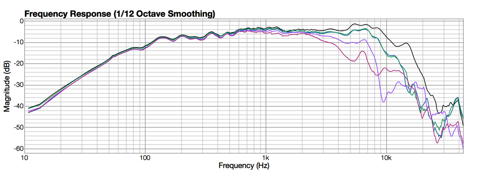

Do note though: as you get closer to the loudspeaker, you hear more of the off-axis response (a lot more - and the diffraction signature becomes more prominent).
..and as I've alluded to before, it's not so much the "side-to-side" that bothers me.
Instead it's the verticals. (..think that one over a bit, or better - model it.)
And it's not just the vertical with any "near-field" design, it's one with:
1. a line source and a point-source,
2. a higher crossover freq. and a faster slope.
3. a midbass driver with a larger diameter and a more directive response at higher freq.s.
Now a possible solution (other than obviously lowering the crossover freq.) is:
-putting the ribbon BESIDE the midbass AND trimming the face-plate to get it closer to the midbass. ;)

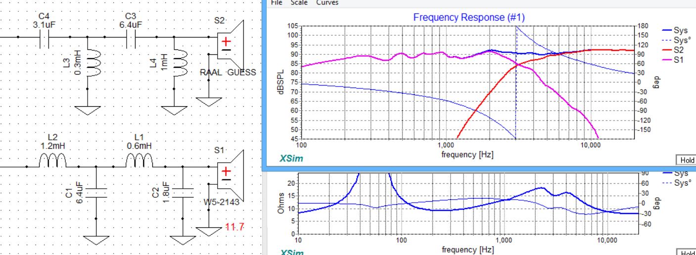

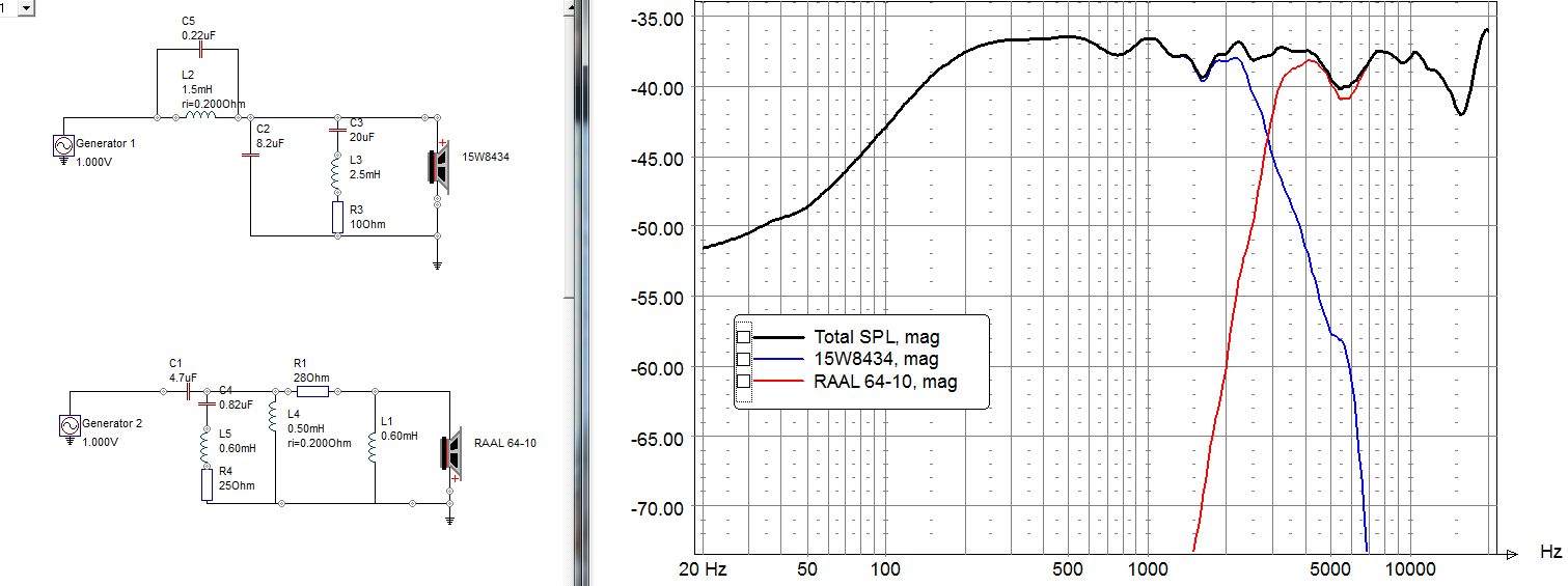

I'm somehow sure i don't have any of the drivers you introduced and i definitely don't have any full-range in my house :)
Now - on the constructive side, while there might be a clue of surround resonance in ScanSpeak 15W it is dealt with in a certain manner - there are little cuts on the cone at the place where cone is glued to the surround that serve to diminish that particular resonance and also the distortion (2nd order mostly) connected to it at that frequency. Measurements of Scan-Speak 15W/4524T02 attached.
attachment.php
attachment.php
Our main concern is vertical dispersion at crossover frequency. Well, the one who has concerns of that type usually doesn't use ribbon tweeter that has 64mm long ribbon - but since the OP wants to use that particular tweeter for his desktop speakers, let us work with that constraints. 4" midwoofer wouldn't be much better in that regard at crossover frequency. But, sitting that close enables us to make some other things possible - as is lowering the crossover point for better horizontal dispersion. Here's quick and dirty 30mins of work. Xover "optimized" for 75cm listening distance. It doesn't change violently going nearer or further. Here is 01:47 at night so it's really dirty :)
attachment.php
I used the files i made long time ago of RAAL 64-10 and 15W8434 and this is full BSC but that can be easily altered by few components value changes (i've already checked it).
As for distortion audibility, i wouldn't start that here. There are few threads that led nowhere and i didn't want to take a part in them. I have my own principles that i'm guided by and one of them should be that harmonic distortion is the last thing i look, but i do look at it when i'm choosing a driver. How much is too much i really don't know so lower=better if everything else is good and equal.

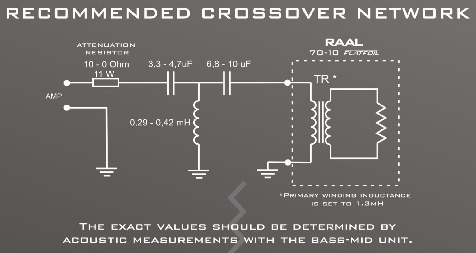

..Even with RAAL's recommended crossover (at 3100Hz) there was not any visible problem in off axis response, and his recommended crossover is for durability - *nobody says that we can not use bigger capacitor and lower crossover a bit for a strict nearfield.
*emphasis added.
Ah, but you've been suggesting that it should be crossed HIGHER in freq. than the 3.1 kHz (with similar filter). :eek:
..and not because of "durability", but "strain" - an audible description.
Drop the crossover freq. enough and I've got no problems with the ScanSpeak's directivity. ;)

RAAL suggested it for durability because it is intended to be listened farfield. Yesterday OP sent me a pm and in it was data where it is going to be used and at what distance more precisely so there is no danger if the crossover point is lower when loudspeakers can be reached by hand. They need some juice in it to be perceived as strained.
Strain or lower durability - it is quite similar to me. I think of myself as somebody that manages well enough in English but it is possible that some finesses are escaping my perception.

I haven't heard any issues with the tweeter with only 4.7uF and 12ohm resistor untill it is quite loud - and that's farfield. Nearfield doesn't need that levels so it should work.

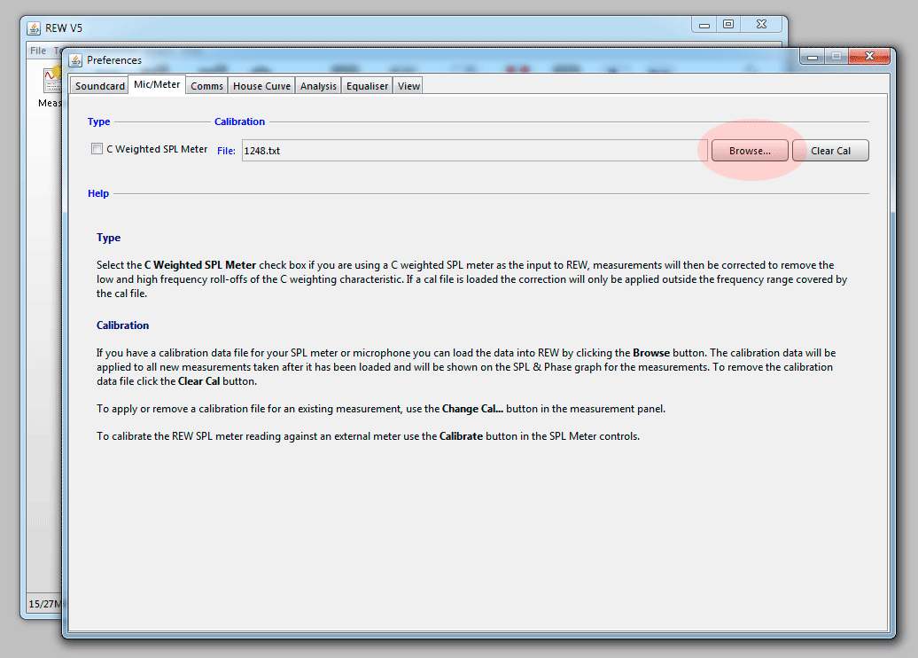

No problem. Before I purchase. will a calibrated omni directional work? I have one which came with an AVR receiver. If not, I'm purchasing a mic!
The calibration file for the mic. is probably part of the software for the receiver. (..meaning your "calibrated" mic. isn't calibrated when used with anything OTHER than your receiver.)
You can still use it of course, but it likely won't be as accurate in the top 2 octaves and perhaps as much as the bottom 3. I don't think either will cause problems with the design work for your loudspeaker.
If you really want an integrated sound-card mic. with a calibration file you can input into the measurement program of choice (..like REW -Room Eq Wizard), then here is suitable offering:

Thanks Scott. But I purchased the Umik-1, and already have RoomEQW installed.
