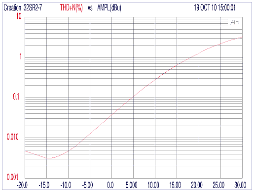

The atch image is Fig 7 (THD+Noise vs. signal level for a NSL-32SR2 configured as a 3 db shunt attenuator with a 2 KOhm source resistance) from the Silonex page at < Silonex Inc.: Products: Audiohm Optocouplers: Audio Characteristics >.
Quickly grabbing two data points, I see 0.010% (-80 dB) THD with -6 dBu input level; and 0.10% (-60 dB) THD with +4.5 dBu input. That's a 20 dB increase in THD for a 10.5 dB increase in input level. Thinking makes my brain hurt, so I will approximate that as a 2:1 ratio. If I recall correctly, that points to a predominantly cubic (third-order) nonlinearity in the photoresistor's V-I curve.
If I re-learned MATLAB I could probably determine the coefficients for a polynomial V-I curve, but maybe somebody who already knows MATLAB will do it.

I don't get this curve...does it mean that the distortion varies with the volume setting or does it mean that the distortion changes with the input level...?? if the latter is the case...it resembles nature i a good way and will thus have a distortion of max 0.025 % at max transient output from the CD (2V).
I believe it shows that THD is a function of input level.
From the description on the Silonex web site, it sounds like the 32SR2's photocell was connected as the shunt element in a simple voltage divider (L-pad) with a 2 kilohm series element. Then the LED current was adjusted until the voltage divider produced a 3-dB loss. (I think this means the photocell resistance was around 4.8 kilohms.)

They say that a 3-dB shunt attenuator is a worst-case situation, distortion-wise. I don't know if they REALLY mean "a 3-dB attenuator will give the worst THD, regardless of the series resistance in the attenuator"; or if they mean "the optocoupler has its worst distortion when when the photocell is near the upper end of its usable resistance range". I'd like to see curves for THD versus attenuation for various values of series resistance - e.g., 2K ohms, 600 ohms, 200 ohms, etc.
