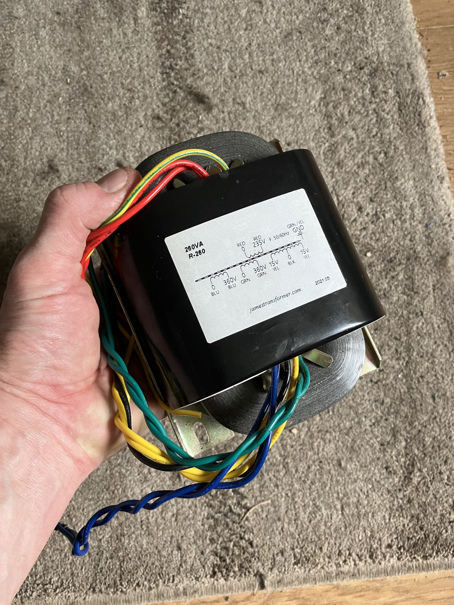

This is a pic of a 260VA R-Core I ordered ages ago for a STAX headphone amp:

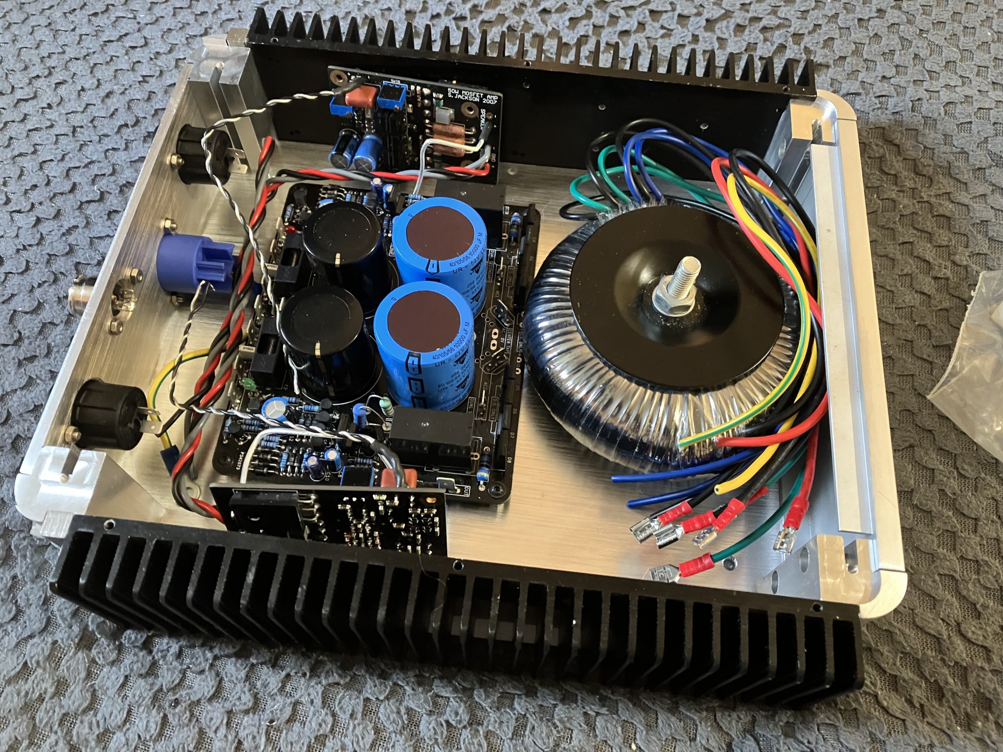

This is my new 150VA O-core from James in a AEM6000 50W amp I'll hopefully finish this weekend:
