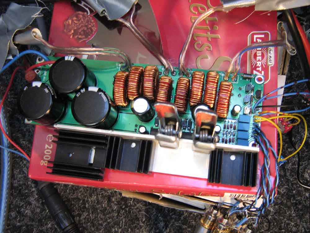

XSpunge - That looks awesome! I bet with those horned tweets it has a nice SPL output. Any idea what SPL @ 3 ft?

Thanks for the compliment. At 3ft its pretty loud at max volume outdoors. You can hear it across the fields where I use them at, so if you were to build a box like it, using an Amp32, or Amp6 Basic you would get similar results (using 4ohm speakers with similar efficiency... 95db for the "woofers" 93db for the mids and allegedly 104db for the tweeters but I doubt that number) I don't have any testing equipment so I can't give quantitative numbers regarding actual volume. All I do know is that it will drown out an Altec Lansing IM-7, a portable boombox for the iPod.
The amp in my pics are 41HZ models, the AMP32, and AMP 6 Basic which is essentially the same thing as the 32 but in a larger easier to solder kit. Both have the same power output and both have a max voltage input of about 14.x volts. ANy higher and you risk ruining the chip. Also, the extra voltage is given off as heat and not used to power the speakers so you don't gain anything by using a higher voltage source you just get a hotter main chip.
The 41HZ amps all have a higher rated power output than the Sonic T Amp (which I also have) and can say that the volume output is indeed higher (when using the same battery and same speakers at full volume) The AMp 32 and the AMp 6 Basic are rated at 25W x 2 channels max output. However that is at clipping and distortion, real world output is lower maybe 15-20W (my non scientific estimation) So it could probably out do the JVC, and especially so if you get efficient speakers at 95dB or higher. The Sonic T Amp will put out a real world output of about 10w with clipping, so figure a little bit less for full volume without distortion.

Regarding batteries, you can find some Li-ion cells on ebay pretty cheap. The ones I use are size 18650 and have soldering tabs so you can put a pack together easily. Each cell is 2400mah, 3.7v but in actuality they will put out 4.2v per cell fully charged so thus you will get 12.6v out of a 3 cell pack. Just solder them in series to get 12.6 volts (although they are called 11.1v packs), then make another 3 cell pack to double the run time. If you want you check the link to one of the auctions for cheap Li-Ion Cells
http://cgi.ebay.com/New-Lithium-Ion...ryZ44028QQssPageNameZWDVWQQrdZ1QQcmdZViewItem
Just disconnect three cells to make 3 packs of 3 cells. Then you can parallel them all to get massive run time.
The charger I use is from www.batteryspace.com and its cheap especially for LI-Ion chargers. It has auto cutoff and you will have to solder on your own connector, but that is easy to do too.
http://www.batteryspace.com/index.asp?PageAction=VIEWPROD&ProdID=2488
It is listed as a 4 cell charger, but underneath that silver sticker is a switch you can select for the 11.1v pack (12.6v). That is the exact charger I use, and I soldered on a connector for my battery.
You can also use prismatic (flat) cells from Li-Polymer/Li-Poly batteries. They are rectangular and are very thin and very light. Same voltages apply to them 3.7-3.8 rated but real world 4.2v per cell. You don't have to worry about discharge rate since D or T Class amps won't draw anywhere near the amount needed for other applications so you can go with normal or lower output cells which are cheaper than stuff needed for RC, wheelchairs, or other high drain devices.
I have an RC Helicopter battery that I sometimes use in a pinch if my main battery isn't charged. It is a Li-Poly battery that is 11.1v (12.6v) and I put the same connnector on it.
I can help you out with instructions as to how to construct a pack if you choose to go with one.
But if you don't want to deal with making your own battery, then Sealed Lead Acid is the way to go. Cheaper, high capacity, but they weigh 5-10 pounds instead of 10-12 oz.
