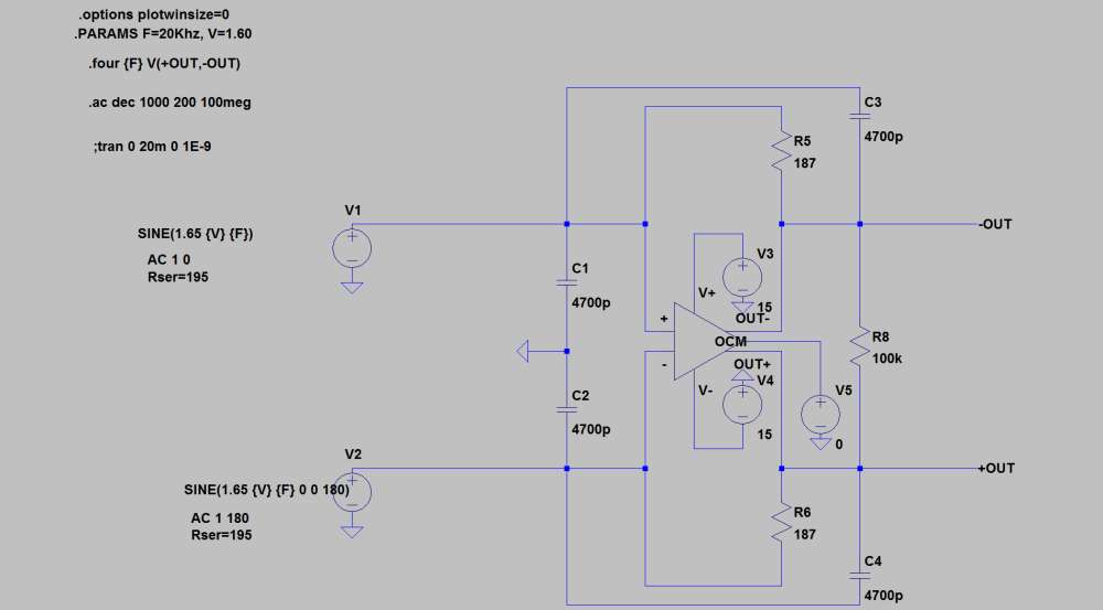

The caps are not for filtering - they are for stability!
If you want filtering, you add a cap across RF; I have simulated this a bit but need to do more.
For simplicity, lets start by considering a single ended case, with an inverting amplifier.
Consider the parallel combination of feedback resistor and input resistor (if any, say 200 Ohms for Sabre) as Thevenin equivalent source, with the FB loop open, but the far end of the feedback earthed (or otherwise driven from a low impedance). This interacts with the capacitor, to give HF rolloff. If we think of the input terminal of the circuit as lying before the equivalent source resistance of the Thevenin source, we find that open loop response of the amp rolls off, with a dominant pole set before the active device, giving overall stability without needing to put a roll-off at some interior point.
Closing the loop flattens the response (of course).
I have to go home now (wife stuck in traffic, dogs to walk, horses to muck out), but will put some simulations together tomorrow to show what I am getting at.
Hi PD,
I have been taking a trip in the wayback machine to remeber what I tested and when.
And I realize it was not the cap to GND at the inputs that was the root of the problem I was noticing.
In fact I just did a quick test with the IVY, and it works just fine. :) In fact I used three values, all worked. 150pf, 1nf, 10nf.
The cool thing is the current IVY board already allows for this. :) It has spots at the inputs for Cs to GND.
Cheers!
Russ
Hi PD,
Ok I have been listening to this all day on a new IVY module I built for the occasion .:smash: Sounds pretty darn good!:yes:
The filter/comp caps are 5% film types.
Thanks a lot for the food for thought.
the reason I had some instability when I tried it before was that I had a series R with the filter caps. This absolutely screws things up!
As shown, it works like a champ!!!
Cheers!
Russ

Great!
You have spoiled my neat theory with some experimental verification - where will it end?
I have used the single ended version of this compensation scheme in power amps, and been very happy with the results - the treble is noticeably "fast" and "sweet", so I had very high hopes for how it might turn out in this application.
A series resistor puts you into the world of pole-zero compensation; it can work, but you need to very specifically tune the series RC time constant (the zero) to cancel the next highest pole of the active stages. Of course, when you do this, you limit the rolloff at high frequencies, but depending on where the amplifier poles lie, you may buy extra bandwidth. If the pole you are cancelling is significantly signal dependent, nasty non-linear stuff can happen, with conditional stability and other horrors.

Sure - Nelson has to get all the credit here, and commercial use (in the US at least) would need a license.
The first requirement for the compensation caps is that they keep the amp stable. Assuming you don't go for pole-zero compensation, this means finding the frequency at which the open loop phase shift is 90 degrees, dividing by the open-loop gain, and so you get a starting approximation for where the dominant pole needs to be (obviously, the requirement is that the loop gain is much less than 1 at the frequency where the total phase shift is 180 degrees). In simple cases, this may be close to dividing the first pole frequency by the open loop gain.
With pole zero compensation, you can divide the second pole frequency by the gain, to get a starting point; in practice I just put square waves in and fiddle till it looks nice!
Beyond that, I don't have much theory; I guess I would like the effective corner frequency to be above 20kHz, so all the music gets treated the same, but not too far above so the active stages are not stressed.
Going too far down in frequency has a noise penalty. As Saber have worked so hard to get fantastic DNR, it seems a pity to spoil this.
I would be delighted if you did board layout, but should probably finish tweaking the design first; there are a few other things I want to try based on your suggestions.
In particular, I want to look at some forms of cascoding, to see if I can improve the stability margin and high frequency PSRR, which is not great at present.
The other question, which is only curiosity really, is if there is any mileage in nesting an inner set of supersymmetric feedback to Q7 and Q8. My first guess for how to do this will kill PSRR, but it is worth a look, at least to understand what happens when you nest supersymmetry.
