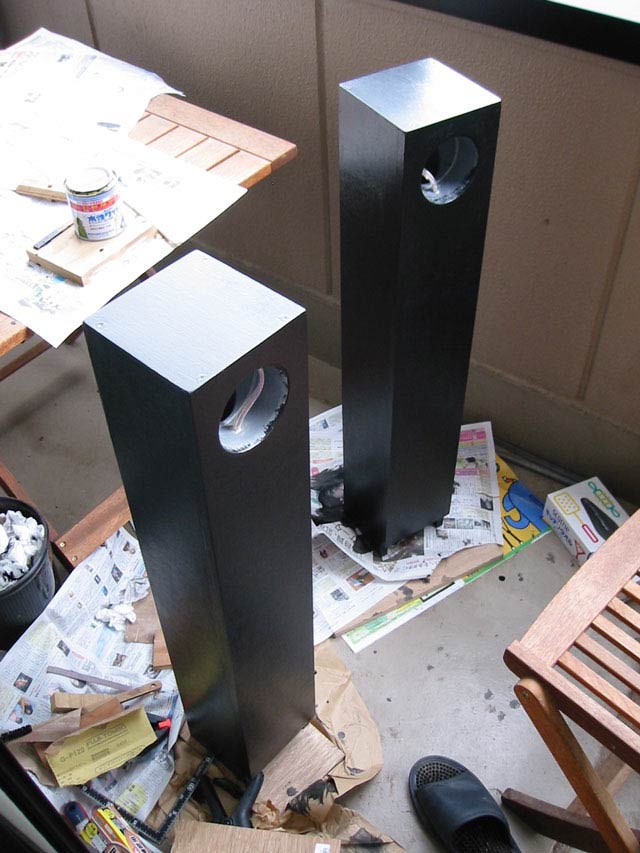

An MLTL is a mass loaded transmission line. Member GM has the most popular and highly regarded designs for that driver on this forum. The driver doesn't dip below 4.5 ohms and should present a fairly innocous load to the Audiolab. One warning, to my ear they start off abrasive with a very long break in and are at all times ruthlessly revealing of the sources ahead of them.
For more mass loaded TL theory detail, check:
www.quarter-wave.com
That system is based on the JX92S. I have not heard it. I do however have a sub/sat system in my office that uses the JX92S in sealed boxes. They sound incredibly good at low levels. I might mention that I got a big improvement in the sound when I started running the satellites through a highpass filter to match the lowpass on the sub. I don't know whether the improvement was simply due to a better match-up at the crossover or whether it was because it reduced IM distortion due to reduced cone excursion on the satellites. I suspect the latter. When they were running "fullrange", I could see quite a lot of cone movement, even though the calculated F3 was 80Hz.

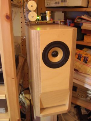

Hello,
I recently made a set of speaker based on the requirement you laid out - clarity at low volume levels. I live in Tokyo and the walls here are wafer-thin, so I had to come up with a set of speaker that I could enjoy without disturbing the neighbours. In addition, these speakers would be used in the tatami-room, so they had to be small and present a decent soundstage when you are sitting on the floor. The WAF-factor also came into account here, it is the Tatami-room after all, so I had to make them look good. They should also be able to back-up as front speakers in my home cinema system, whether I use the projector or TV.
Now, with these requirements I made a bass-reflex system based on the Fostex FE107. I created a slim box and used a PVC-pipe to create an internal volume. The space between the pipe and the box was filled with fine-grain sand to absorb any vibrations. I am not sure how much this will contribute to the actual sound, but I can definitely say it was worth the effort, because I can draw great pleasure simply by rapping a knuckle on the speaker and point out to anyone who is close-by, that the speaker is indeed filled with sand ("See? It is completely dead, like a concrete wall!").
The box is tuned to 88kHz, and there is therefore no real bass to speak of, but I find that the speaker works very well for the design intent I had. I am not saying it lacks bass, I does have it, but it is just not the thing you would go for to play rock, it is more suitable for more mellow listening. Furthermore, the soundstage is quite narrow, there is a definite sweet-spot that would render it less suitable in a home cinema setup, but I usually watch movies alone, so this is not an issue for me.
This was only my second project so I cannot place this speaker in reference to something else, nor do I have any equipment to measure its output, but I think the FE107 would work well for what you are trying to achieve.
Best of luck!
Best of luck!
