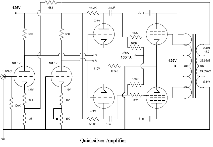

I had a pair of the Quicksilver KT88 amps back in the 1980s. I had to buy a quad of 5AR4s at a time and ended up with stacks of them by keeping a quad or two in my stock. I sold the amp but kept the 5AR4s and they are now worth more than the amp....
I asked Mike Sanders for a schematic and he told me to draw it out myself; so I did.

From the schematics it is easy to see why his rectifiers had short life. They were expensive and didn't sound good at all to me.
I think the Rectifier issue has been beaten to death by now. Everyone knows that first cap was almost 10x too big and gave those rectifiers a real short life. The couplling caps at 400v were not spec'ed high enough. Yes, got it.
Short of the reliability corrections, is this amp worth building? I think so. I like how simple it is. Williamson may sound better (maybe?) but too difficult to get dialed in correctly. This is why I initially asked if there were any real improvements with the tubes I have...but I think I will stay with the original design, and a KT88.
You can modify the power supply but will not be enough. That simplicity is the main limitation for its performance. I didn't like it. I would rather build an amp from a classic Acrosound schematics. Like this below. The TO 340 was 5K plate-to-plate.

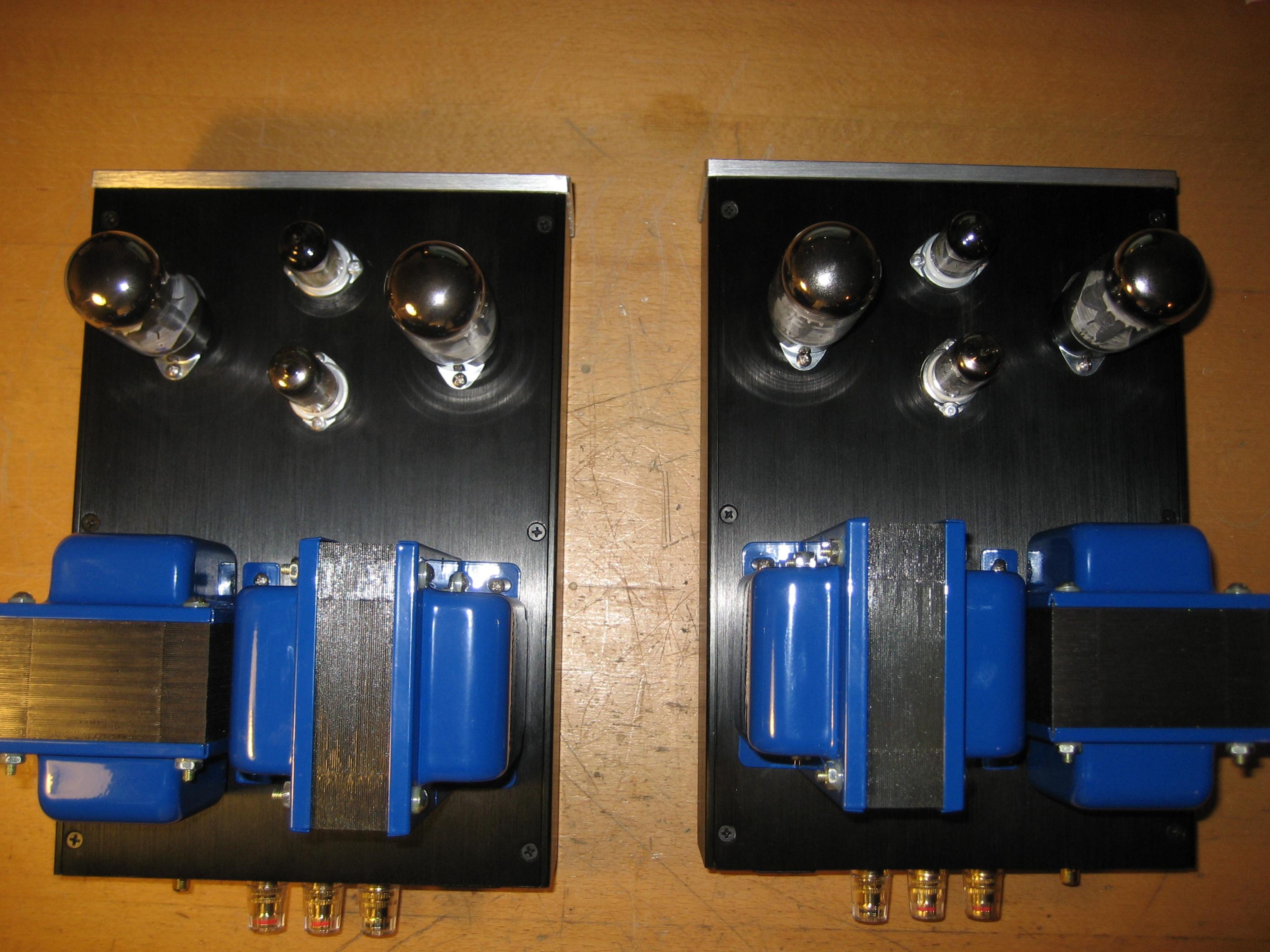

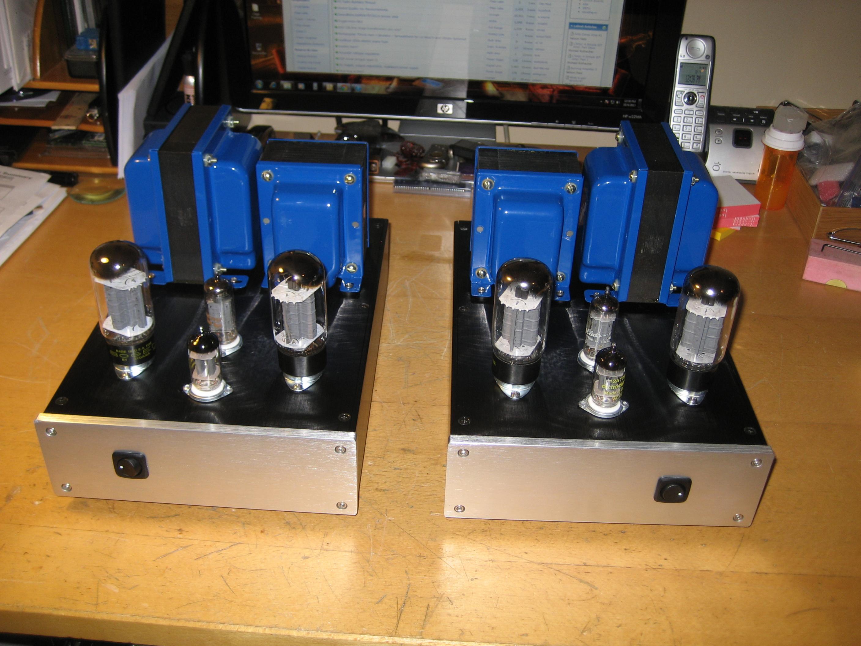

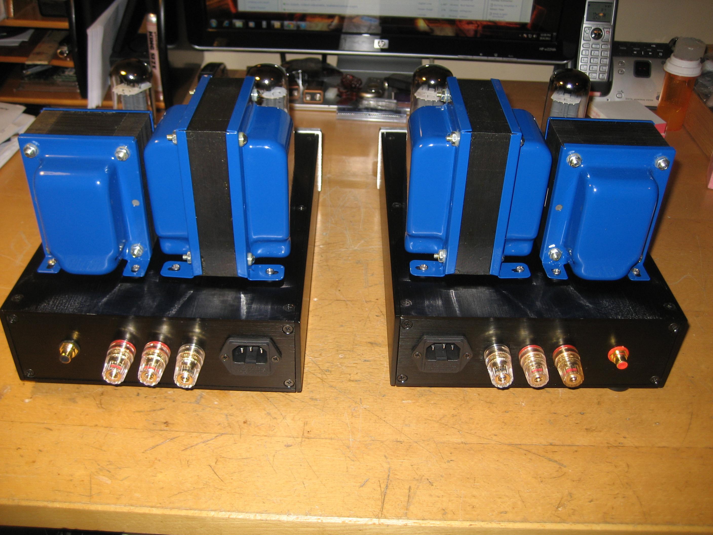

Bah! I will stick with the original 8417 design -I even bought a quad of 8417 Sylvania tubes...simple changes: dual bias adjustments, and maybe a 6922 instead of the 12BH7, and some of those nice Russian .22uf/600V mylar coupling caps...Some pics (finally!) Just need to solder everything together...looking good so far...

Hello all, I have a quick question - these 8417 are to be biased at 100ma (50ma each tube). I am planning separate bias pots and meter points per 8417 output tube. Does the 50k bias pot have this current running through it? Reason I am asking I am trying to size the pot (1/4 watt? 1/2 watt 2 watt?). If I do the math, I should have around (60V - 15V) = 45V across the 50k pot so 45*45/ 50,000=.04 watts...but if the entire 50ma current goes through the 50k pot, we are talking a lot of wattage
The ones I normally see for fixed bias are usually only 1/4 watt.
Administrator
Joined 2004
I use 2W locking pots for bias, usually ETI purchased from mouser. Search on RV4LYSA503A at mouser.com and you will get the 50K locking pot. Only the bias currrent of nearly a mA flows through this pot.
Conservatively rated and reliable, I have never had a RV4LYSA series pot fail on me. (Made also by Ohmite and CTS)
I would recommend a lower value pot frankly of 5K or 10K with more current flowing through it. This will make the bias less prone to changing due to grid current, for the same reason adhere to the recommendations about max grid circuit resistance for the 8417.
