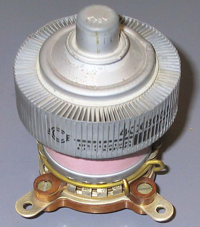

Fins... you want fins... no glow on these
dave
