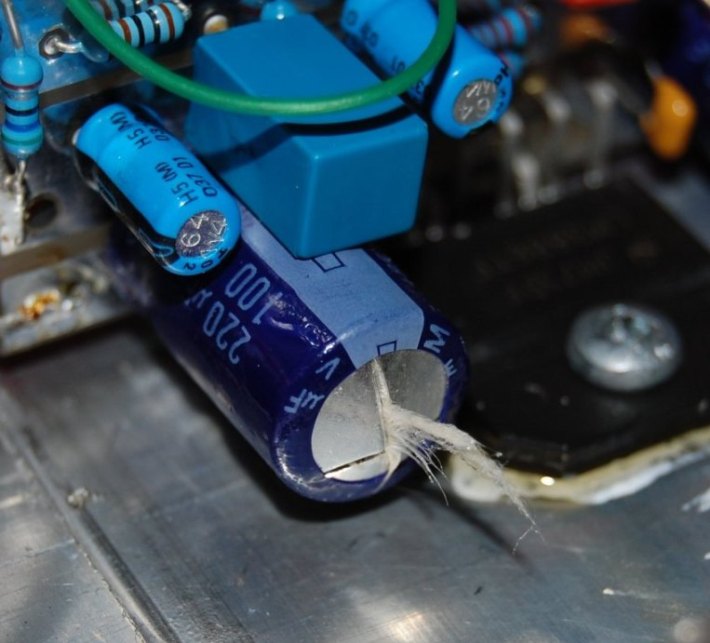

gain said:hence no power (heat) can be produced within a cap!
In an ideal, perfect capacitor, you would be right. But most caps, especially big electrolytics have significant resistance (ESR) and this does produce heat when large currents flow.
10A through 100milliohms = 10W
AndrewT said:Hi Gain,
capacitors do generate internal heat.
It comes from the ripple current and the ESR.
This heat is the reason for the limitation on ripple current and if ignored will destroy capacitors.

BUT , try hooking up a cap reversed biased (I did this by
accident..reversed rails ) ,the cap got so hot
I had to dip it in the sink!!
BTW ,the caps survived but giving it FULL AC at reverse
polarity could of boiled a cup of tea.

if you have a 1000uf cap that averages 1amp ripple current, if we assume no ESR, then no problem, there is no heat generated since the voltage and current are out of phase. if we assume .1 ohm ESR, that would give a 0.1 volt drop across the series resistance, giving an average wattage of 0.1W. not a lot, but it does still generate some heat. this heat is generated in the plates and electrolyte, and causes a miniscule amount of evaporation, which after time raises the ESR, and thereby the amount of internal heat. let's just say for argument that the ESR doubles for every 500 hours of use. if we started at an ESR 0f 0.01 ohm (good for a brand new cap), how long would it be before the ESR got to a critical point (where the cap is generating 2 or more watts of heat, enough for a catastrophic failure)? about 4,000 hours. of course the operating parameters as well as ambient temp have a large effect on the climb rate of the ESR. and in most circuits, the climbing ESR would cause other problems usually well before the internally generated heat has a chance of causing a catastrophic failure.
to connect this back to the original topic, the longer you operate electrolytic caps, the closer they are to the end of their limited life span. the problem with powering up and down all the time is thermal expansion causing 1) stress rings in solder connections and less frequently 2) failures of some semiconductors. in vacuum tube equipment constantly turning equipment on and off causes early failure of tuve filaments.

90 degree V/I phase shift is theory book jabba, doesn't take ESR and leak current losses into acount.
You could consider taking the wrapper of lytic parts Off.
