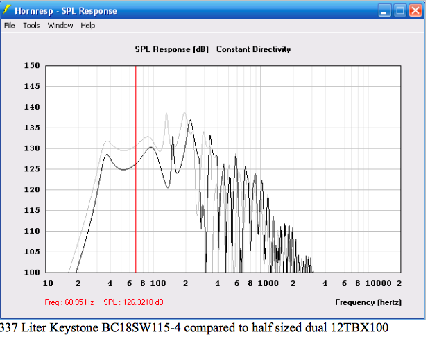

Comparing the output of a 337 liter single B&C loaded TH it is easy to see that a single 18 TH has similar output capability using less than 1/2 the volume of the 797 Liter 12Pi FLH, using about half the plywood.
Add a second (relatively)small TH, gain 6 dB, and there is no doubt the TH are louder, and a lot easier to move up ramps single handed.

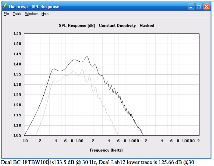

Even without the thermal consideration, a pair of B&C 18TBW100-4 in the same cabinet volume are capable of about 6 dB more low frequency output than the stock Lab 12s.
A six dB difference at 30 Hz sounds about twice as loud, the B&C loaded FLH can do 133.5 dB at 30 Hz, the 12Pi 125.66 dB, a 7.84 dB difference.
Having compared a pair of stock Lab 12s to a B&C18SW115-4 in the same cabinet, I’d say the real world difference would be closer to 10 dB, the Lab 12 is not very good at loosing heat.

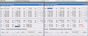

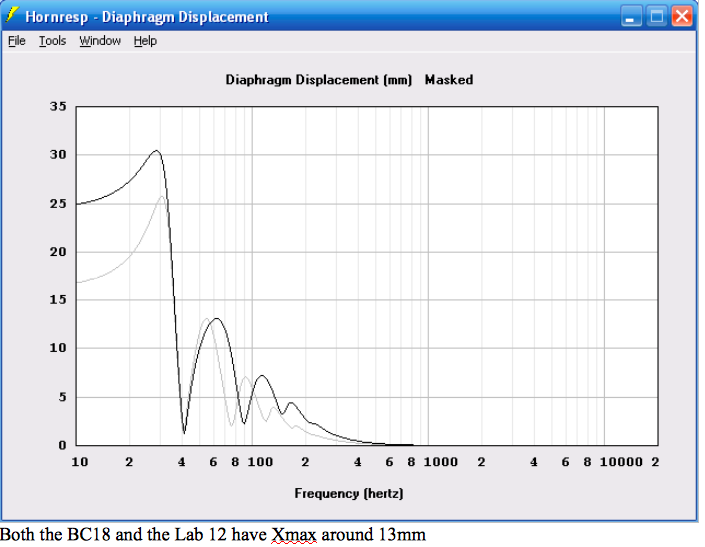

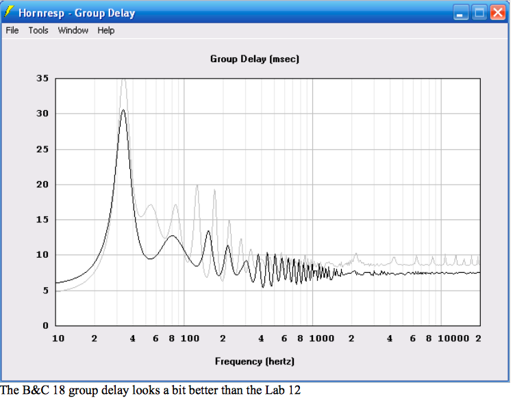

The 12Pi dual Lab 12 Hornresp sim averages 134.2 dB (131.7 at 40 Hz) using 57 volts, 2.3 ohms, 1413 watts (706 w.p.d.), louder than any of the Keystones, but is over twice the size and weight.
