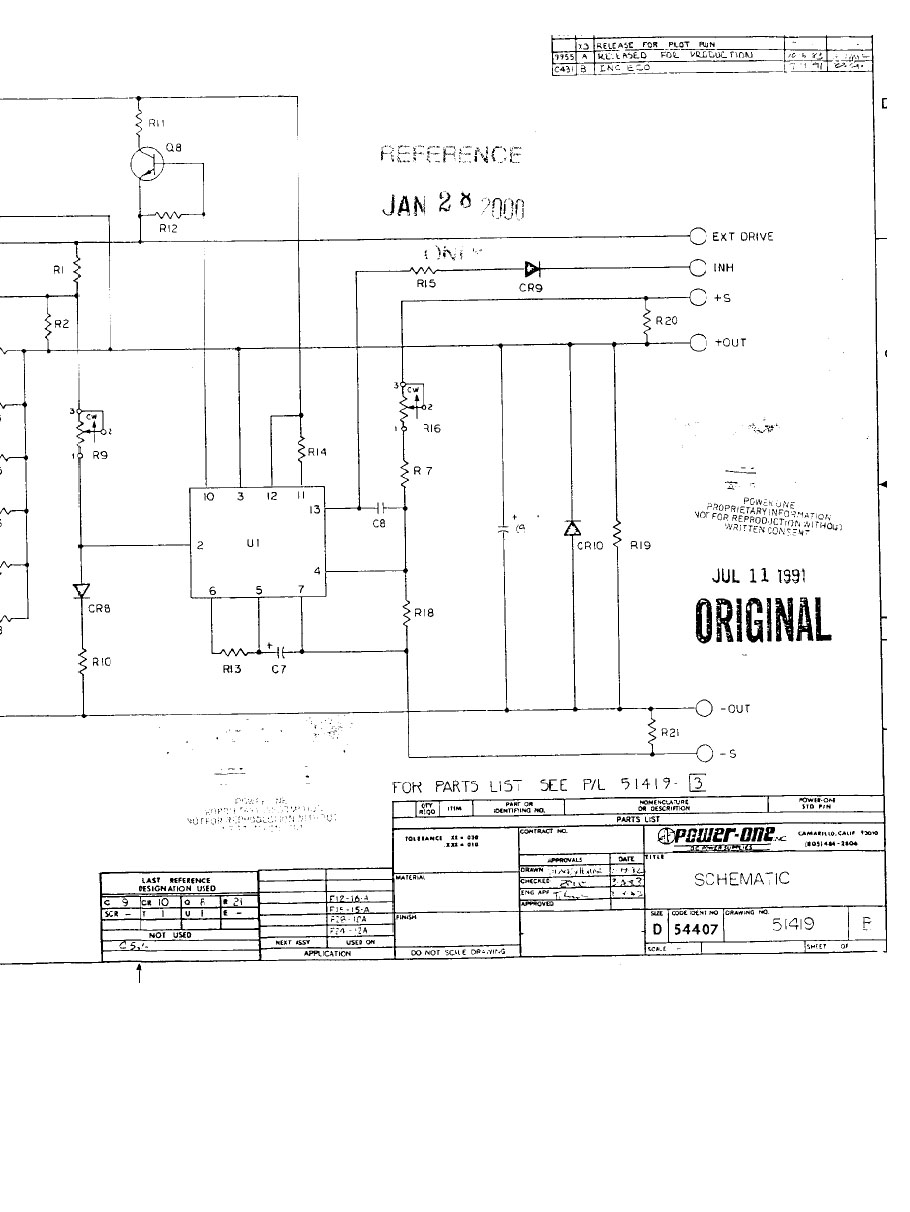

I have (2) PowerOne F24-12-A International Series power supplies.
1 of which is being used as my BenchPS and the other has a toasted TO-3 HBR along with the associated trace. Repair is not impossible as I also have the schematics.
Is it possible to connect the OP in series to obtain a +/-24V ultra smooth reg PS? Or would another (puffsst) occur?
I have a 38VCT/10A transformer rated @10A and the associated 30Kuf caps to replace the BenchPS, so no worries there.
I await the replies of diy PS guru's.
Hmmmm..
Ok. One more question.
This is just a thought as I am no EE.
With 2 diodes in parallel what is dramaticly changed? (other than board realestate.) rV/rI/Pd?
And if there is a dramatic change (> +/- 10%) at what point could the law of DR take place??
[and yes I am 'nuke-ing it a bit here. As I have sort-of misplaced that there 'I-Believe' button of mine.]
