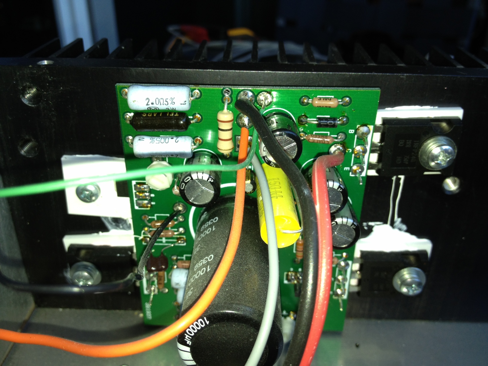

Quick direction please for Firstwatt F3 DIY
I need to connect the signal input wire and ground wire to the RCA plug and am on an iPhone without PCB schematic. Im staring at these two wires and know for certain one is input signal and the other ground...im just not sure which is which. One wire is soldered to the board adjacent to V- input and mid size elytic cap...I think this should run to the RCA connector ground but want to confirm?
The other wire (which I think is the signal input wire) lands on the middle of the board adjacent to the biggest cap, also flanked by small resistors and the smallest of the four transistors. I assume this is the positive for signal input?
Thanks Nelson. Pic of one channel of the F3 is attached....
Green wire lands on PCB in top-middle of pic near the thick orange wire (signal out to the speaker terminal).
The thin black wire is in left-middle of pic to the left of the big black cap and also just above a few small resistors. Since there are more than one black wire...just to be clear its the thin black one flanked above by the green wire and flanked below by the orange wire.

Looks like a Zen 9 board. See attached.
I don't know your board, but it looks like the black wire closest to the jfet is actually the input.
The green wire is a ground point. I assume this because the large black wire at the top of the photo is close to the Voltage in.
In the PDF below, there are a couple of ground points in that area.
My advice is to take the large ground and send it to an isolated point (not on metal) and begin a star ground. Remove the input ground at the board.
From the RCA input, run a ground to the star ground. Do the same for the speaker ground. Run a single thick wire to a CL-60 thermistor and attach it to a post on the metal chassis. (Clean the metal around the post. You can make a post with an inch long screw and nut. Use two nuts and a locking washer to lock it down.)

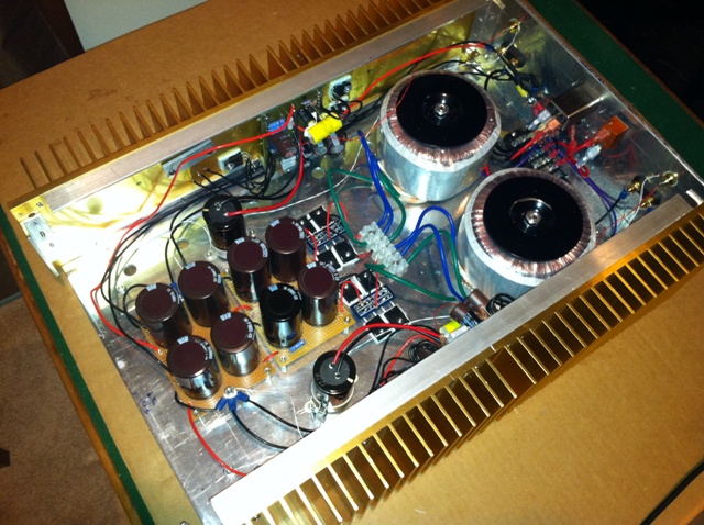

Here's mine. Ya-Ba!! Nice looking right? ;)
See the the star ground? It's near the last power supply capacitor at either side of the capacitor bank. Don't do what I did!
Place your star ground closer to the middle of the amp as possible to shorten every possible path. Keep them away from transformers, if possibe. The 0v off the power supply ties into the star ground.
A good star ground point is usually at the 0v on the capacitor bank.
There are good examples out there, just look through previous build photos on this site.

hi,
these are F3 Boards.
on the left side the black wire near the LUI should be the signal +
Signal- should be connect anywher to GND
On your pic:
Black (thin) = RCA +
Red `= VE+
black (thick) = VE- / GND
Orange = SPK -
Grey SPK +
Green RCA-
HTH & cheers
Thanks Vince and TP147...much appreciated!
Your feedback mirrors my intuitive guess...thanks for the confirmation...I soldered it that way last night and crossed my figures that I would not have to wake up this morning only to have to reverse the wires based upon your feedback.

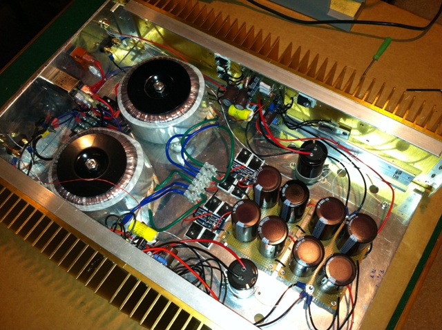

hi here is a pic of my F3:
It is only a 2HE case with 80mmm heigh.
The FFETs are all mounted to the inner heat sinks, Q2 and Q3 right in the corner to the outer heatsinks.
The coupling from inner to outer HS works well. With environment temperature of 20° C the inner HS is arround 48°C with Cover on top. If Environment is above 24 °C I lift of the Cover. Outer HS is always 3-4° C lower.
Don't bother with the amps near the transformer. My boards are quite near to the transformer and the F3 doesn't make any noise with no signal.
The rect diodes are mountet to the small inner HS you can see in the center of the case. With high environment temperature an cover on top th HS is arround 55° C and inside the head of the inbus screw is arround 10° C higher!
