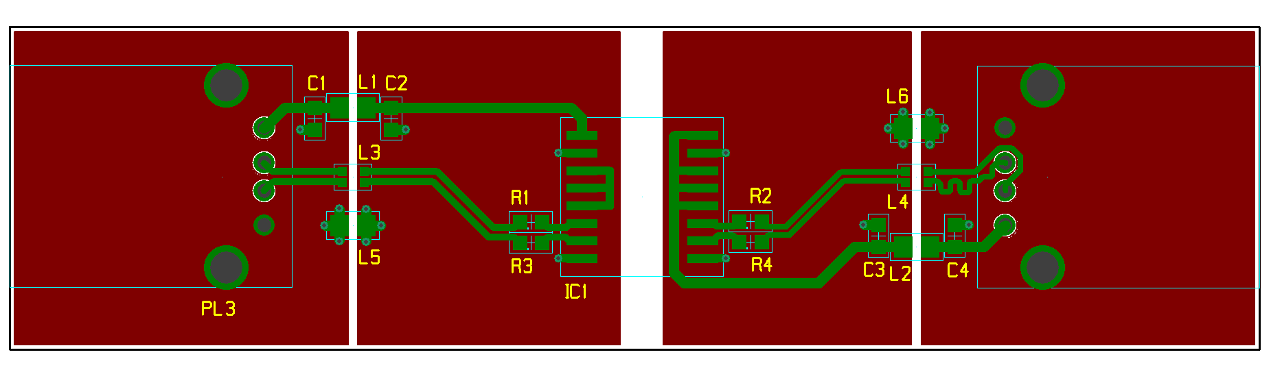

Now before I get accused of this and that, here is a little USB isolator I played with, that could easily be modded to remove the ADUM and add a little extra filtering for the 5V, the design and techniques for isolation were drawn from my day job experiences, which just happens to be laying out PCB for quite often high reliability products. The isolation derives from work I did with an RF engineer working on noise isolation for some aerospace stuff... so my view is if it works fro something as boring and mundane as that then there is the possibility it will work for audio stuff...
If you fancy doing you/our own version let us know, I till have the schematic and PCB layout, so can easily MOD them to provide filtering only...

Yes it is a common mode choke, you can also add ESD protection devices as well.When we do USB layouts, nearly every one has a common mode choke on the output, I'' try and blast through a few boards and get the part numbers, but the one I linked to above should do USB1. The data rates can vary, but the background noise spectrum will be similar as it tends to be with any digital system, as it is quite often the digital switching that creates the noise, not just a stray SMPS, and often SMPSs can be a minor contributor to the overall noise.
The main difference between the layout shown above is the isolation of the ground plane using ferrite beads to form a definite moat, this avoids any capacitive coupling between the input and the output. Doing the design as Audioquest has done it means you have capacitive coupling, any noise will just couple back in.
If I get chance later today, I'll remove the ADUM device and add a big choke (ala AQ) to the 5V and possibly a common mode for it and the ground line.

Firstly the design I put up is a generic USB isolation interface, the only difference from the generic interfaces is the deliberate isolation of the grounds and lines via moats, bridged by a ferrite bead for the Ground, a pi filter for the 5V and the common mode choke for the USB lines. This layout is effective at reducing parasitic capacitive coupling (one of the main coupling mechanisms for high frequency noise, such as found in digital data), the ferrites and pi filter proving high frequency filtering (this can be tailored by the choice of ferrites and capacitor values).
In this instance, as in most uses of Adum USB isolation in electronic equipment, the Adum is not to isolate noise, but to isolate one piece of gear from another from overvoltage. This interfaces main function is to protect the main unit from a sub unit going bang and causing high voltage to appear on power and signal lines, thus the main unit goes on working (in this particular case you want it to work, it’s from some medical kit we worked on).
The main point of me posting this design is to show how to isolate USB when using a filter, if you don’t have defined moats clear of copper you are going to get capacitive coupling rendering the filter useless. The design in question and the layout techniques was developed for some other equipment, where as I said I worked with an RF engineer where we achieved immunity up to 18GHz, so the layout and filtering has been tested and measured and proven to work.
Further to jitter through the Adum, there have been threads where this device is used and I believe there may be some jitter figures. The data sheet gives a figure of 3ms and some other figures for data transition, that sort of thing, I leave to the electronic engineer I am working with. My concern is providing the best physical interface for the signals and power to travel around and provide the best signal integrity and noise immunity from said layout. The Adum’s are only good for USB full speed, though again from discussion on another recent thread I do believe this will cater for even high res audio over USB.
The point I am trying to get across is that if you are going to do a filter product then it needs to be done correctly, and physical layout is paramount, done incorrectly it negates the filtering. In this instance the layout inside the jitterbug is not optimal and there are numerous coupling paths for the noise. I would have used the techniques shown in my layout as I know for certain that these work having been proven on numerous bits of kit (measurements and data is covered by NDA's and other restrictions).

Anyway it should be quite interesting as this thread has been put up on another forum by one of my old sparring partners from here SandyK, so I expect some comments... That said I stand by my opinion that the layout is essentially flawed for what is being claimed for filtering...:)
I'll have to have a look later, the traces are done for 90 R differential impedance, suspect the PCB was less than 1.6mm to get this impedance without t6racks about an inch thick.
I tend to use Saturn PCB toolkit for initial impedance figure, then fine tune it using myy SIV add on or talk to the PCB manufacturer who uses Polar software.
The design was thrown together mainly to show how to do the isolation, the original board was a 8 layer, with multiple ground planes so signals always had a return layer next to them.
