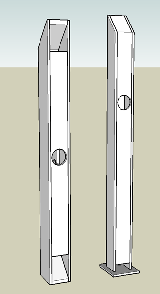

I went to Home Depot today after work to get the wood, and boy, was I disappointed. No 1/2" birch ply, only 3/4". The only thing I was told that's closest is "sandeply", which is "kind of hardwood". Is that stuff any good? Also, they won't make any cuts smaller than 12", so I can't have them cut into strips. I may need to go to a real lumber yard...
I only have a circular saw, so having the four sides of each speaker cut to the right widths at the lumber yard would be great.
For wires, I just need 24 ga. solid core, not necessarily cat5, right? The cat5 I was planning on using _is_ the stranded patch cable. If solid core is better (for sound and for securing the wires), I can just get a few feet of it from Home Depot.

What you get for construction grade plywood, and "sand ply" is construction grade, depends on where you live. Here in the South, you get lobloly pine. Useless for speakers -- full of voids and warps like mad. Obviously, the HD "associate" does not know his stock very well. HD has birch and oak veneer "furniture" grade plywood in 1/4" and 3/4", but this stuff usually has too many voids for speakers. A real lumber yard might have baltic birch. I have to go to a specialty shop to get BB. Finally, you do not want HD or Lowe's or most lumber yards to cut your panels. They are not going to be nearly accurate enough.
You can get very good cuts with a circular saw if you use a fence. Search a wood working forum.

You'd be better off with 1/2" MDF, or better yet, OSB than the plywood usually found at HD. I see that you're in a coastal state, so odds are that there is a marine lumber yard not too far from you. If you're set on ply, and can't locate the good stuff (Baltic birch) you might try the marine yards. One of them will stock Okume marine plywood. I've never used it in speakers, so I can't vouch for Okume's sonic qualities, but the stuff is marvelous to work with and finishes a lot like mahogany. It'll be a bit pricey, but then so is quality BB ply.
As others have said, the quality of the HD ply panels is all over the place. It's a real morale crusher to learn that a loose ply in a hidden void comes to life and buzzes every time the program material gets close to it's resonant frequency in your newly finished masterpiece.
That said, I have seen, at both Lowes and HD here in Houston, an occasional stack of very nice birch ply. It is definitely not the same product that usually fills that rack. I suppose that when you're buying and distributing such huge lots of stuff, a few quality pieces can sneak into the supply chain by mistake now and then.
The conductors won't matter in your application. Solid or stranded will sound the same. Just tin the stripped ends of your stranded 24 ga and get after it.

I didn't realize how difficult it is to find Baltic birch ply, let alone 9-ply variety! I just called the only lumber yard I know of in central NJ, and they only have regular birch, 4-ply (already at $56 a 4x8 sheet).
Can anyone suggest suitable substitute that are perhaps easier to find? Would some sort of solid wood shelving (pine, or even oak) be acceptable? I don't know if they come in 1/2" thinkness, but at least I'd seen the 3/4" ones in HD/Lowes.

You give up too easy. Yellowpages.com is your friend. Call around to some of the custom woodworking places, someone will know where to get some BB.

I built a pair using 3/4 inch pine some years back, they looked great, didn't have any audible nasties and were easy to assemble. They imaged like crazy but the mids weren't as good as I wanted. I was using the drivers (Radio Shack 1197's) that ended up in my "High-Tweek Black Box Monitors," which, are much better overall.
I'd be very tempted to try the Vampyr (spelling?) using 3/4 pine as it's an interesting looking solution. I wonder if it's tuned a bit higher than the Zigmas, and that might be a help in the tonal balance.

Got the wood--- the lumber yard was kind enough to cut 4 4-3/4" strips and 4 strips just shy of 3". I'll probably get to start this weekend.
One question: The "terminals" on the drivers don't seem to have marks to indicate polarity (they look identical to me). Is polarity not important for these drivers?

You might like to look in your local IKEA store. Check out their shevling. Much of it is of suitable size to make speaker cabinets.
Not perfect, but just a thought ...

fishline said:The "terminals" on the drivers don't seem to have marks to indicate polarity (they look identical to me). Is polarity not important for these drivers?
Yes it is... all the Fostex i've seen are marked.
