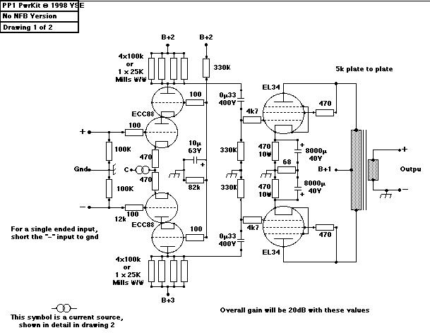

As long as the sum of the cathode resistors and the sum of the feedbacks remain constant, the input receiving triode gets the same NFB as the secondary remains floating. What bothers me the speaker wire can as antenna inject noise to the input.

A good way to ground and ac gain balance is to use an adjust on the secondary of 500 ohms, it will ground by 125 ohms and offer you overall ac balance gain adjust.
