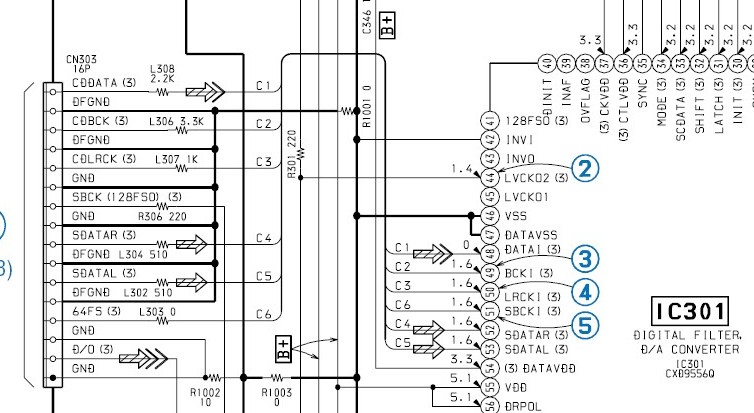

i have attached a schemtic of the Sony Audio board DAC section which is a VC24+. The connector shown comes from the logic board to the Audio board.
Question i have now is, wether it is possible to get the DSD and PCM stream before the VC24 DAC chip.
My assumption is that DSD is at :
51 Sbck (Bit clock)
52 Sdatar (Left channel data)
53 Sdatal (Right channel data)
PCM at :
48 Data (PCM data)
49 BCK (Bit clock)
50 LRCK (Left right clock)
does this make any sense ? I might want to try the Sabre connected to Player ...
