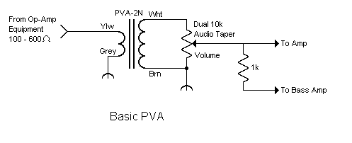

The Neutrik transformers are readily available with me and that is why I had asked. I think the Neutrik NTL1 is having almost similar specifications as that of the Magnequest B7-10K:10K version.
1. What will happen if I omit the 1K fixed resistor that is added across the secondary to create an idealized constant ? Will it significantly degrade the performance ?

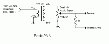

First, non of the Neutrik transformers are very good. Second, I do not think they have the same specifications as the B7. Only in the very limited specifications given are there some parallels.
What 1K resistor across the secondary? Neither does the drawing attached to your post show such nor was any such ever in any published "Ingot" drawings.

The 1K resistor is shown at the output end after the pot. What is the best value for the log pot (Is there any specific reason for using the 10K version) ?
Yes. And next to it it says "to bass amp".
So why do you claim that this resistor: " is added across the secondary to create an idealized constant ? " when it clearly is not added across the secondary first of all, never mind the rest?
The value that matches the transformer of course.
The secondary winding of the transformer in your drawing is 10K impedance.
Plus, there are the usual considerations for "passive pre-amplifiers", which pretty much dictate a 1K pot to be desirable (but few sources sound good driving such a load) and a 10K as the upper end of the value range, to ensure reasonably wide system compatibility.
