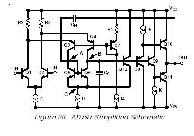

The simplified schematic shows a diff pair with a folded cascode and a current mirror load. This is followed by two stages of emitter followers. This is simple schematic showing only the basic outline of the signal path. But as op amps go this is a pretty simple topology and not near as convoluted as many I have looked at.

Hi Sy:
>the 797's diff input is cascoded, current mirrored, and bootstrapped six ways from Thursday. Is that possibly the reason for the low bias current?<
The cascode part of the 797 is of the inverted/folded type, which is good for stability and bandwidth, but AFAIK, means little for the base or bias currents of the input diff pair. The second-stage current mirror just sums the plus and minus portions of the signal into a pushpull output, with probably very little effect on the input base or bias currents.
Finally, the major bootstrap mechanism in the AD797 maintains a constant voltage across the summing current mirror, which will kick up the OL gain a lot, and I think will also help the PSRR on the minus voltage rail. But again, I doubt if this represents any direct advantage for input base or bias currents.
Of course, there is always the possibility that the real AD797 circuit is far more intricate than what Analog Devices chose to publish.
best, jonathan carr

"Of course, there is always the possibility that the real AD797 circuit is far more intricate than what Analog Devices chose to publish."
That is why it says simple schematic on the drawing from the data sheet. I feel quite sure this is nowhere near the actual circuit and would image that the bias compensation network is one of the bits not shown. Op amps are very proprietary. The reason Spice models are grossly simplified macromodels is for both the protection of the design and lengthy simulation time for a model that represented the real complexity of the design.
