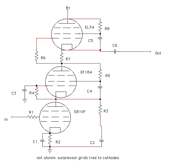

I sketched up a crazy little thang, a cascode with a triode strapped pentode in the top position. The cascode would be a triode strapped bottom tube with a grounded grid pentode on the top.
As for the transistors , already done it man... and with Jfets downstairs too, and with a mosfet ccs and a jfet bottom element with 1/2 of a 6922 in the middle. I want to see how far tubes will go. I'm tickled by this pentode idea.
Could someone tell me if I am barking up any kinda worthwile tree with this attatched schematic sketch?
Output node impedance is shunted by (R5+R3)||R8. Without putting specific values in, or analyzing what happens at the (number tubes please; I'll number top-down) T2k-T3p R3 R4 node, I'll guess that gain is no more than 3 times higher than one pentode with a resistor load.
If not for that shunt, I'd say T1 needs a grid-cathode cap somewhere to hold its current more-constant.
> if you are dealing with input voltages of a few volts, then there is usually some audible clipping going on there.
Transistors don't have to clip.
And think: if you have "a few volts", and want gain more than you can get in one R-C 6AU7 stage (~400), then you have more than (few * 400) = a thousand or more volts of output swing. If you truly need such input and such gain, maybe you do need the 30,000 volt supply.

I think you might be going too far with the analysis etc.
In PRR's excellent first post to this thread the key was given. The gain of a cascode is APPROXIMATELY gm x RL where gm is the gm of the lower tube (device) and RL is the load resistor on the top tube anode (shunted by the load).
In simplest terms all you need to do is maximise both. If you want to get fancy then:
1) Maximise RL by using a dual PNP transistor Current Source load as per SY's suggestion.
2) Increase the current (and hence the gm) of the lower tube by adding a resistor from the lower tube anode up to the positive rail. This increases current in the lower tube while leaving the top tube alone.
As another line of investigation - also covered in PRR's post, run a single tube (Hi mu - say a 12AX7) in current starved mode for maximum gain and enhance that with SY's dual PNP current source load. This method WILL suffer bandwidth problems due to Miller capacitance.
Either method should give you more gain than you can possibly use.
In rational design, this does little good. Yes, Gm increases with current, but the increased signal current from the higher Gm splits between the upper tube and the bypass resistor. If upper tube Rk is lower than the bypass resistor, then I suppose most signal current flows to the upper tube. But if you also increase upper tube plate load to very high impedance, and upper tube Mu is not very-very high, its Rk will be quite high (about (R+Rp)/Mu or so). And we usually want good output current to drive a load and/or stray capacitance.
In irrational design, with kilovolt supply or very high Z current regulators everywhere, I dunno. All the easy assumptions fly in the face of electronic reality. "Infinite" impedances never turn out to be as infinite as you hoped.
There's a reason most Classic tube design can be understood at a glance. It Works. Anything tricky usually does not work any better than the same number of parts laid out simply.
I assume you have chewed the Tube Op-Amp thread SY started. I haven't; I caught the tail of that era and don't remember it fondly. But Julie (link, link) and others were getting gains of 20,000+ in compact little modules without any coupling/bypass caps. There's trickery in that, but nothing like this cascoded CCS-ed bleeder plan. Remember, when Julie started there was a war on, opamps aimed anti-aircraft guns faster than humans, and heroically complicated designs were justifiable and even built.

In the next week I'll be breadboarding what I see as the most extreme, but still useable variation. Just a simple 2 triode cascode in the bottom with an EF184 pentode CCS on top of it. I'm interested to see how my math will hold up in the real world. Everything is snubbered and bypassed at first with grid stoppers on every grid. That's going to be my test bed. I'm starting out with 7-pin VHF/RF tubes, and I'll move on to high GM russian tubes and the like if things look good.
