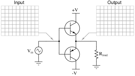

Does a push/pull amp just not source current from V+ through the output transistor through the driver to ground? Then sink current from ground through the driver through the output transistor to V-?
The red terminal is providing all the grunt/volts whether they are positive or negative and source/sink current to ground.
Assuming black is neutral or earth then red is the "hot" terminal.
For AC red must push or source current and pull or sink current.
Black being neutral therefore sinks pushed/sourced current and
sources pulled/sinked current, all driven by the red voltage.

Two 'groups' of transistors are arranged such that each group generates one half-cycle of the audio signal feeding the loudspeaker.

Attached is an image from melab-bd that I keep on my phone, to show customers when trying to explain how their amp works - in fact, the whole site may be of benefit to the OP.

Or probably he says this regarding your understanding on amplifiers? What is category 1,2,3 and 4?
I love your
Could you slow it down a bit so we can follow the voltages more easily?
image from melab-bd
see.. this is the THIRD type of amplifier design.
where it was specifically said.. one terminal outputs the full bias while the other terminal simply adds a sink.
the FOURTH type that i was talking about is kinda like this one, except the sink is biased in relation to the other side, thus creating the clamp.
going by the third amp design, i would use a resistor on the positive speaker terminal and not worry about the amplifier seeing something with 2 ohms on one side and 4 ohms on the other rail.
but
with the fourth type, i would need a resistor on both sides again since each side has an input and and output.
(the third amplifier type basically says the red is input and the black is always output.. while the fourth says the red is input as the black is output, but both the red and black terminals are biased for input and output to create the clamp i was talking about)
see..
i knew it made sense that i thought it might ever be possible for 11 watts RMS to be combining from each side to create the full stride of 22 watts.
No. The two halves of an amplifier don't operate independently,
even when you bridge amplifiers, you still only need one resistor.
You never need two, two is the same a doubling one resistor.
If you think otherwise, you thinking is not right.
rgds, sreten.
but
see..
Try to het your head around that the current goes into one terminal, goes through everything it encounters (speaker, resistor, cabling) and comes out EXACTLY THE SAME at the other end. There is only ONE path.
Amps may be configured with a push-pull stage internally, but for the speaker hanging on the red and black post it's all rock and roll. Just current passing through, back and forth.
If you'd manage that, you'd make a huge step forward.
jan
see..
Nonsense. Remember: there's only ONE path. If you have a 1 amp RMS signal current going through your 2 ohms speaker, the speaker will dissipate 2W power from the amp. I^2*R.
If you add a 2 ohms resistor in series, that resistor will see the SAME 1 amp RMS and being 2 ohms, will also dissipate 2W. Total the amp delivers 4W, half in the speaker and half in the R. Simple, no?
And it makes no fukkie difference whether the R is on the black or red post, or in which order the R and speaker are interconnected, as long as they are in series. Same current, remember? You DID get that, didn't you?
jan
